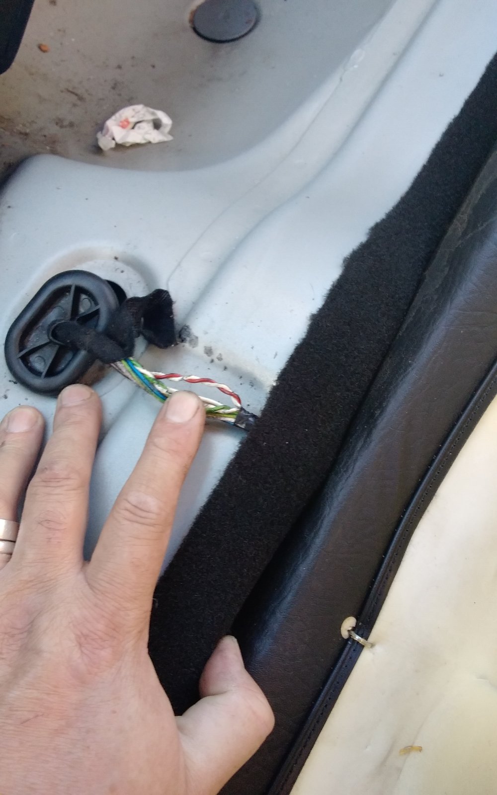

The problem is a wire to rear left sensor heres what i have done.
Probed all the sensors there all good probed the loom everything good apart from one wire rear left .
Unplugged the plug from the abs mod probed each pair of wires and same readings all good apart from the rear left , so its down to a wire, a break in the loom, and guess what its under the exhaust and a heat sheild... so im almost there.
Husky.

Re: Airbag, Dashboard, Seat Belt & Airbag ECU Repairs
Thought id add this as i thought it was for the rear abs its to the rear speaker.
Husky.
All sorted, 4 wires on the abs loom plug, cut out the old broken wires new water tight connectors both rear wires then closed up the female connector pins all put back together 20 yard drive all lights off and still off , car now has new MOT
Husky.
Wrong it is for the rear abs sensors !Huskyxantia wrote: 01 Nov 2021, 15:45 Thought id add this as i thought it was for the rear abs its to the rear speaker.
Husky.
