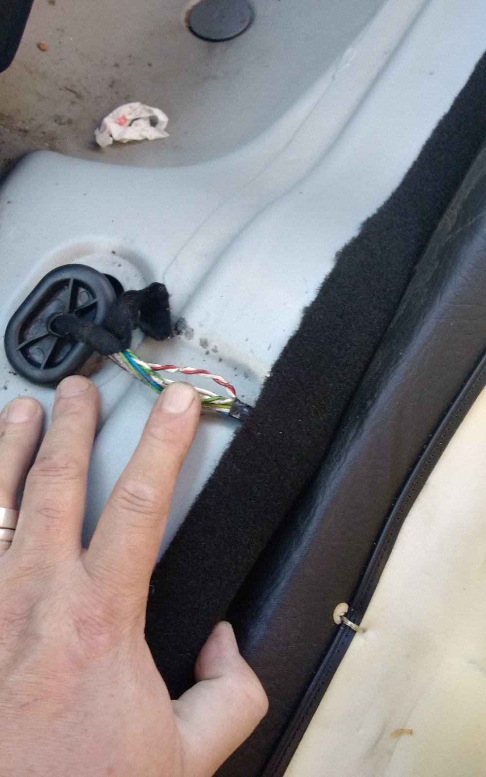

Thought id add this as i thought it was for the rear abs its to the rear speaker.
This isn't abs loom its for the rear speaker

All sorted, 4 wires on the abs loom plug, cut out the old broken wires new water tight connectors both rear wires then closed up the female connector pins all put back together 20 yard drive all lights off and still off , car now has new MOT

Huskyxantia wrote: 01 Nov 2021, 15:45 Thought id add this as i thought it was for the rear abs its to the rear speaker.
Wrong it is for the rear abs sensors !
