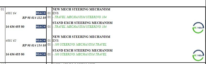

A friend recommended these guys
https://www.lionautomotive.co.uk/produc ... ering-rack
Do these numbers give any clue about compatibility? Will call them on Monday
Compatible OE Numbers:
400165
400164
Their return acceptance criteria are interesting.

They are both old numbers & have been superseded by the new numbers shown.

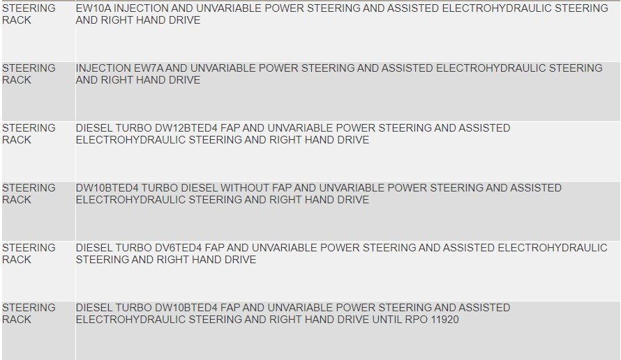

Those numbers come up for 6 different variations of the C5 (X7)
