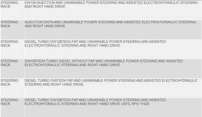

There is no mention of transmission or suspension taking the DW10BTED4 as an example - both parts are stated as possibilities for the models with electro-hydraulic power steering (which was the only type fitted to this engine). The build date is the key factor it seems as other modifications could of been made as well as wheel sizes that may of been specified as an option - but again, wheel sizes are not stated against the different rack part numbers, only the build dates.

Those numbers come up for 6 different variations of the C5 (X7)
