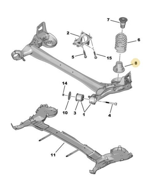

thanks for your help, I'll head over now and have a look, the only other thing is there more then 1 bleed screw?
I followed your guide on the timing belt and it was great help, very nervous on start up but had previous issues with timing belts (long story) so I wanted to donate to say thanks basically.
I am after a suspension set up for the rear of the DS5 as I'm making an air suspension set up for it and wanted to know how the bump stops were held in before ripping it apart

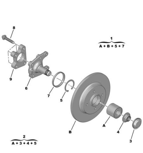

Ok, so here are the three Suspension diagrams:
