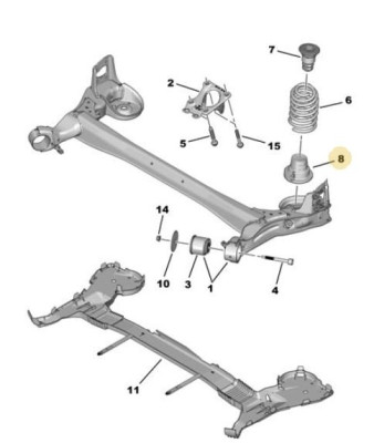

I am after a suspension set up for the rear of the DS5 as I'm making an air suspension set up for it and wanted to know how the bump stops were held in before ripping it apart

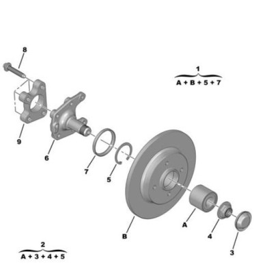

Ok, so here are the three Suspension diagrams:

Thank you
