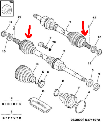

Officially, Citroen certainly don't supply the ring as a separate part - and consequently there are no removal and refitting procedures for it. You can probably obtain one from elsewhere and fit one yourself though.
But, here, as you can see where I've marked in red, you can just see the ring:
