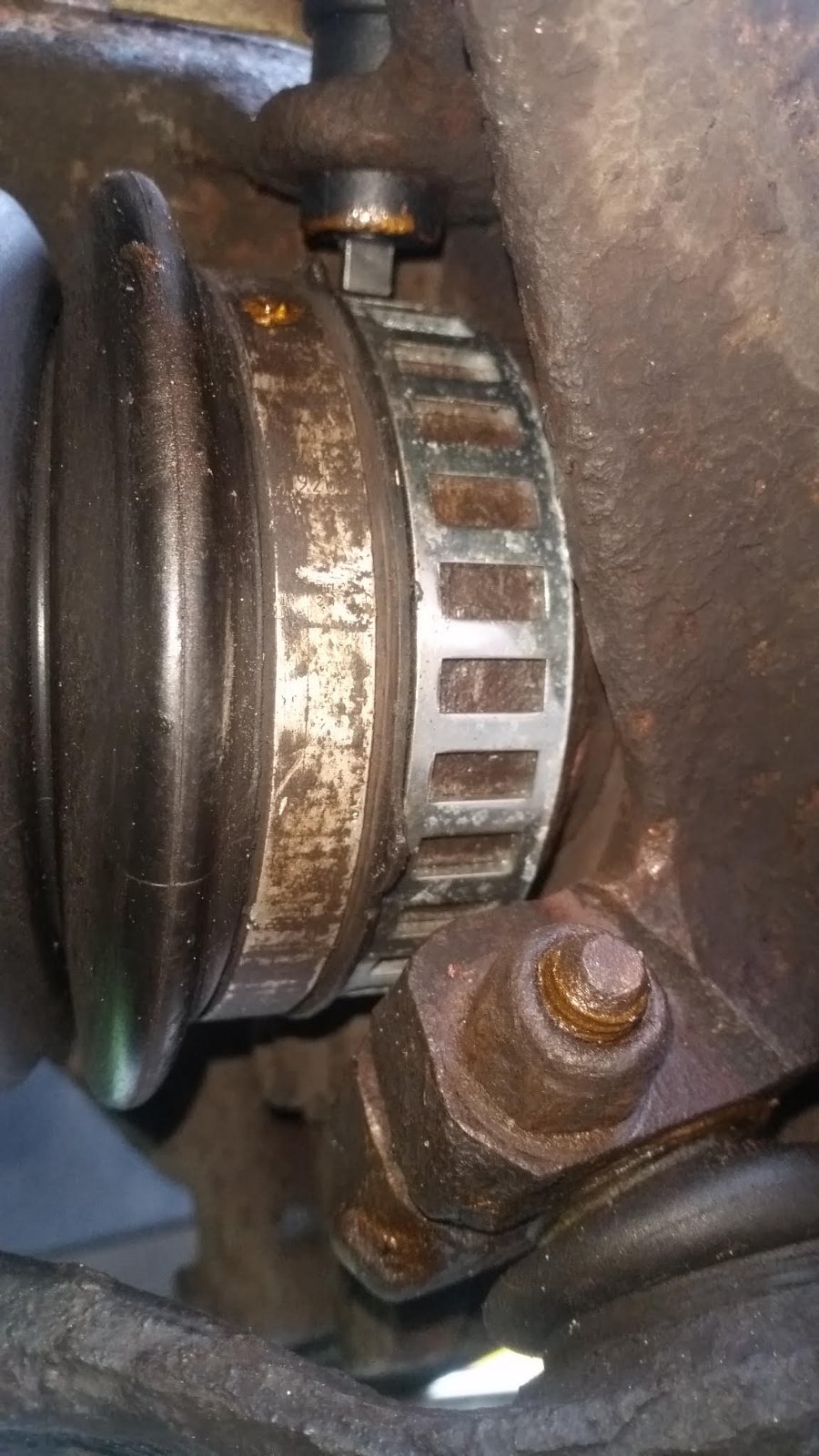

Officially, Citroen certainly don't supply the ring as a separate part - and consequently there are no removal and refitting procedures for it. You can probably obtain one from elsewhere and fit one yourself though.
But, here, as you can see where I've marked in red, you can just see the ring:
Click or Tap Image to Zoom

Hi Marc,
Apologies for slow reply ...
Thanks for the diagram. Helps a great deal.
I will have a go at this now the weather is a bit better (for the moment anyway).
Best wishes, Can K
