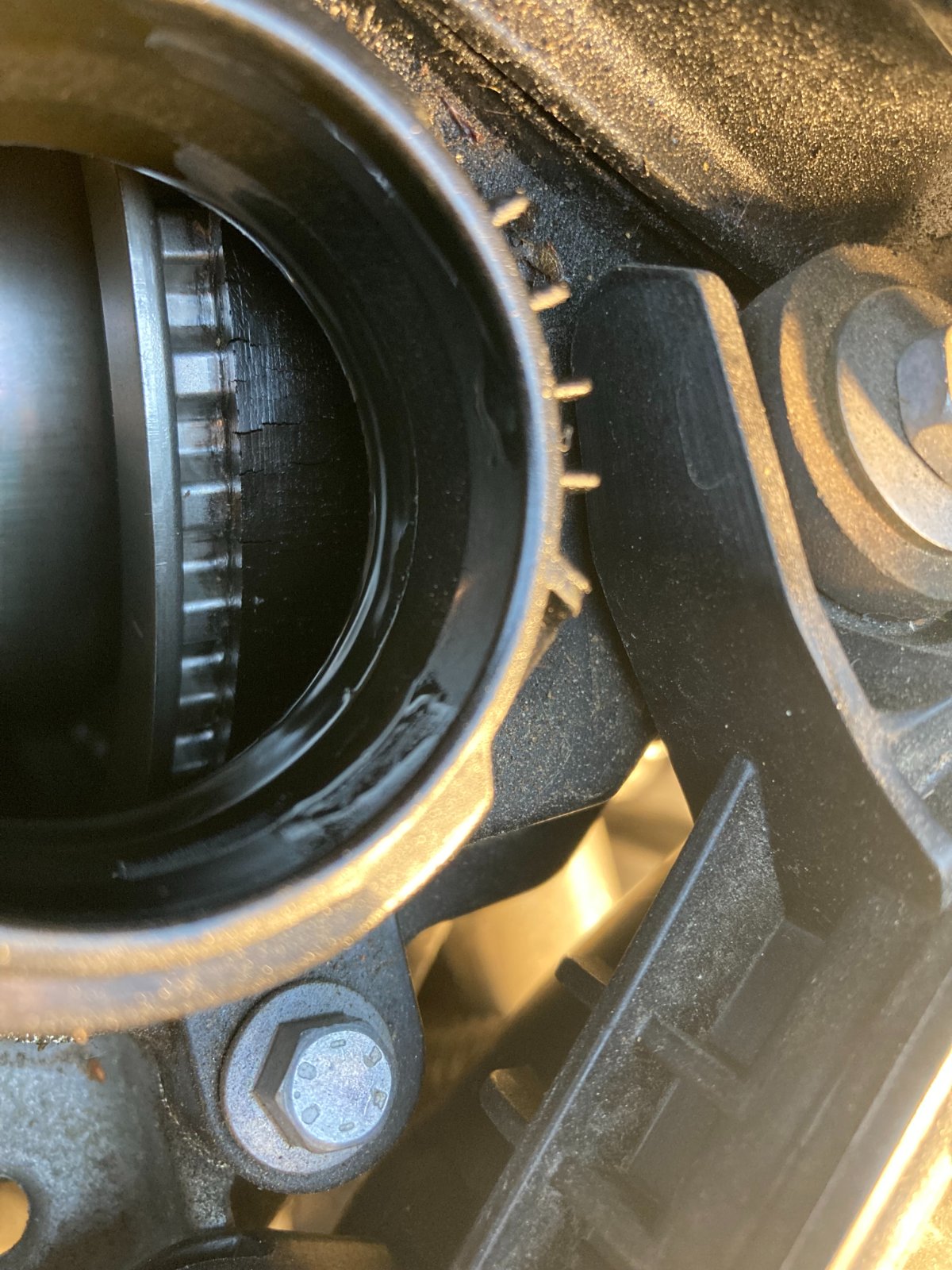

I've called up the dealership (Robins & Day), who have booked it in for diagnostics, but not until 11th Jan. Which leaves me carless for now.
I removed the oil cap and took a photo of the belt, which I've attached. No idea if it looks bad or not, but thought I'd share.
Thanks
Luke
Thanks
Luke
- x 6961
Re: 2008 oil pressure switch location (2018 130BHP)
That doesn't look too healthy to me! It's hard to tell, but the older belts do 'shed' and this can lead to blockages.

The official test is to measure the width, but that looks knackered to me!!
