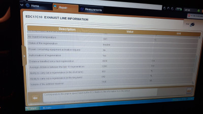

Ok,
Some info to report back...
Cars been sat for 7 hours so cold.
Cleared fault codes as suggested,
Looked at exhaust line information with engine off, that sensor is reading 149°C
With the engine running still the same and also at approx 3000rpm still the same 149°C
You can see in the image the temperature gauge of the car is on next to zero as just started up..
Thanks

Re: Peugeot 207 fault code P1490, P242F
Post by RichardW »
I can't see an O2 sensor on the exhaust. The temp sensor is located half way down the cat / DPF, next to the top pressure sensing pipe, I'd start with checking the cable to it, and measuring the resistance.
