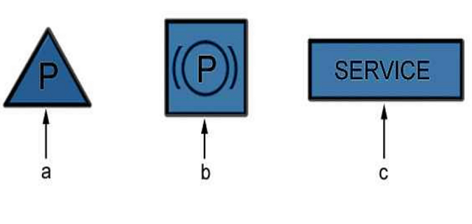

Hi Darek. The ABS ESP Units must be correct for the vehicle and if using a second hand unit, the ECU will need checking and possibly programming to match the vehicle options on your Picasso.
These are the fault code explanations:
Switching on of the warning lamp and/or warning message :
"a": Electric parking brake fault warning lamp
"b": Electric parking brake warning lamp
"c": Service warning lamp
So either they have the incorrect ESP unit fitted for your vehicle, or they have not programmed it correctly, or they have damaged the CAN wiring.
At present the ESP ECU is sending out 'rubbish' (coherence fault), so the data is not being interpreted correctly and therefore switches off all the ESP functions.
For now, until you can get it to a proper mechanic who knows what they are doing, you will have to hold the electronic handbrake button on for at least 3 seconds after you have switched the ignition off to engage the handbrake.
