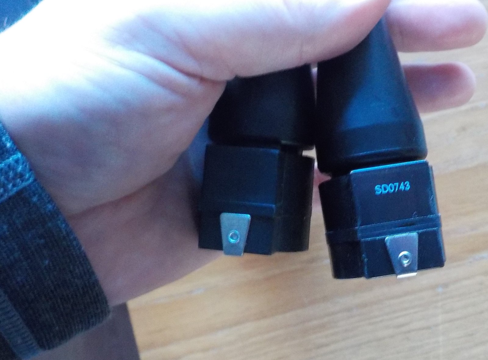

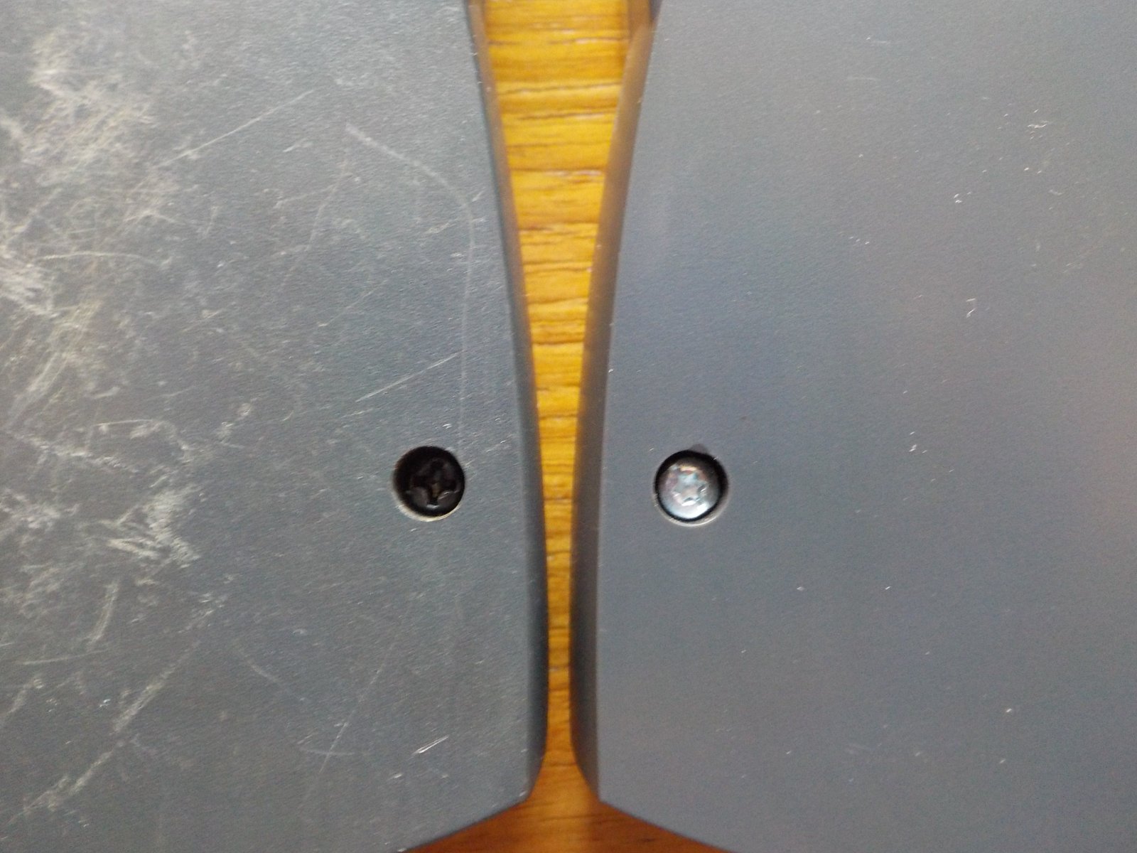

Most of your observations seem to be correct about the fake interfaces however I have a genuine interface & it is definitely made in France.
In the pics below the genuine one is always on the right.
The fake one i have here was given to me by a friend to test as it stopped working. I opened it up & there is some sort of burnt out relay.
Anyway my observations between the real & fake ones are:
I had never noticed the numbers printed on the round connector before as its always had the little rubber scratch protector on it.
The serial numbers on the fake are indeed the ones you say.
- The fake ones don't come with the stickers applied but come on a separate sheet, unless you have a robotic hand theres no way your getting them stuck on like they came out the factory & I'm pretty sure there will always be signs of them not being perfect
- There is an obvious difference in colour of the main sticker here but I suspect this may be down to usage oily hands etc. Mines is well looked after & always kept in a ziplock plastic bag when using to keep it looking new. This unit is about 13/14 years old believe it or not
- The fake one has a round CE sticker on it that was definitely not on the original
- The screws holding it together on the fake one are black Philips head, the real one small silver Torx heads but with a slot so a flat head can also be used
- The sticker on the back of the real one says made in France as it does on the fake one. I can't imagine the would not have just copied an original one??
- The little loop thingy where the cable goes into the interface is on the opposite side of the real one
