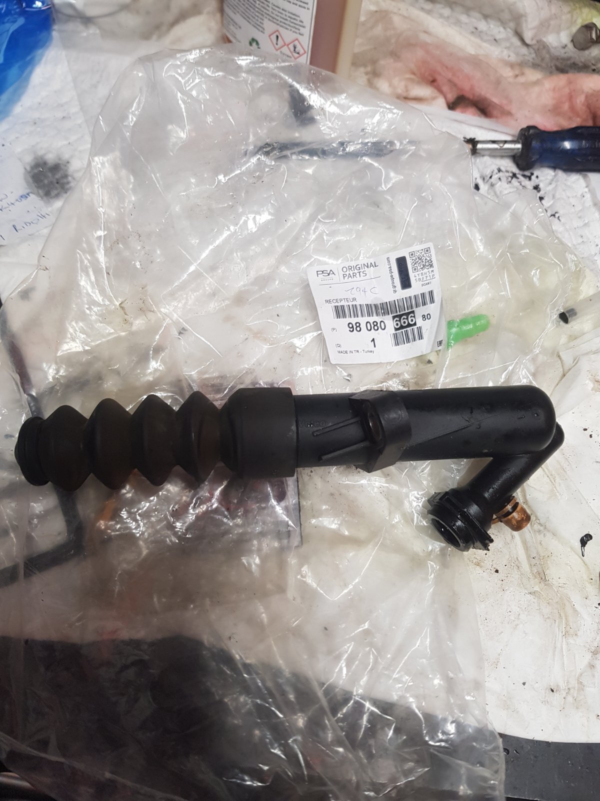

The unit I have is not the two detailed above.
There is only one clip and the bleed is on the side
Part number 9808066680
