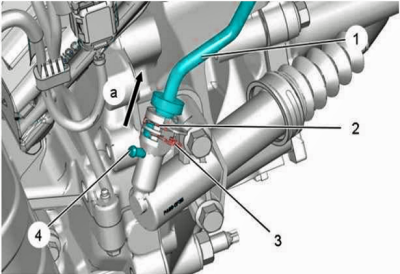

Ok, here you go, these are the correct bleeding procedures. I've listed all the variants, just read through them all to make sure you have everything covered.
There is more than one bleed system:
Remove components as necessary for bleeding the hydraulic clutch control.
N.B.: Use exclusively the hydraulic fluid(s) approved by the manufacturer.
ESSENTIAL: During the bleed operations, take care to maintain the level of brake fluid in the reservoir by topping it up (If necessary).
Before any operations:
CAUTION: When coupling and uncoupling, maintain the hydraulic pipe in its axis and do not lever it, so as to prevent any rupture.
Remove the protection cap from the bleed orifice (4).
Store the protection cap in a clean place.
Connect a transparent tube onto the bleed orifice (4).
CAUTION: The end of the transparent pipe must be submerged into the brake fluid.
Clamp the clip (2).
CAUTION: The clip (2) must always remain clipped in position on the hydraulic clutch slave cylinder during the bleed.
Unclip the clip (3).
Pull on the hydraulic pipe (1) to free the bleed orifice (4) (In the direction of the arrow "a").
Allow the brake fluid to flow out by gravity until there are no air bubbles.
Clamp the clip (3).
Push in the hydraulic pipe (1) to close the bleed orifice (4) (In the opposite direction to the arrow ).
Fill the brake fluid reservoir to its maximum capacity.
N.B.: Two people are required to perform the following operation.
Pull on the hydraulic pipe (1) to free the bleed orifice (4)(In the direction of the arrow "a").
Press the clutch pedal slowly down to the floor.
Clamp the clip (3).
Push in the hydraulic pipe (1) to close the bleed orifice (4) (In the opposite direction to the arrow "a").
Unclip the clip (2).
N.B.: Manually refit the clutch pedal in its high position.
Repeat the operation until the fluid running out is clean and free from air bubbles (20 times minimum).
Top up the brake fluid to the level marked previously.
Refit the brake fluid reservoir cap.
Uncouple the transparent pipe.
Refit the protection cap on the bleed aperture (4).
Check the travel of the hydraulic clutch control slave cylinder (see corresponding chapter).
CAUTION: Check that the bleed opening (4) is correctly closed by operating the clutch pedal several times Check there are no leaks or seeping (risk of vehicle fire in the event of a leak).

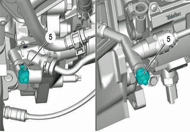

Bleeding: Hydraulic clutch control (Screw bleed system)
Quarter turn system
Remove the bleed screw (5) protection cap.
Couple a transparent tube on the bleed screw (5).
N.B. :Two people are required to perform the following operation.
Retain the clutch pedal in the lowest position (end of travel).
Open the bleed screw (5):
Close the bleed screw (5):
Disconnect the transparent pipe from the bleed screw (5).
Refit the protection cap on the bleed screw (5).
Check the travel of the hydraulic clutch control slave cylinder (See paragraph 4).
CAUTION: Check there are no leaks or seeping (risk of vehicle fire in the event of a leak).

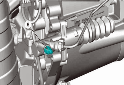

6-sided screw system
Remove the bleed screw (6) protection cap.
Couple a transparent tube on the bleed screw (6).
Turn the bleed screw (6) (Anti-clockwise).
Allow the brake fluid to flow out by gravity.
Close the bleed screw (6) (Clockwise).
Refit the brake fluid reservoir cap .
Refit the protection cap on the bleed screw (6).

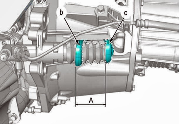

Checking: Travel of the hydraulic clutch control slave cylinder
Measure the travel "A", from the clutched position "b" to the declutched position "c".
The travel "A" should be between 18 and 22 mm.
If the value is incorrect : Repeat the bleed operations.
- Double-clip bleed system
- Screw bleed system
- Mark the level of brake fluid in the reservoir
- Remove the brake fluid reservoir cap
- Fill the brake fluid reservoir to its maximum capacity
Clamp the clip (2).
Clamp the clip (3).
Clamp the clip (3).
Quarter turn system
- A half-turn anti-clockwise for a hydraulic clutch control slave cylinder
- A half-turn anti-clockwise for a bleed union
- A half-turn clockwise for a hydraulic clutch control slave cylinder
- A half-turn clockwise for a bleed union

The unit I have is not the two detailed above.
There is only one clip and the bleed is on the side
Part number 9808066680

Is there a mistake with this? In the first part for the double clip system it says -
but a few paragraphs later it says -

I read this as ok, as it's telling you to clip at (2)max1 wrote: 30 Oct 2024, 19:47 Is there a mistake with this? In the first part for the double clip system it says -
Clamp the clip (2).
Bleed Procedure
Clamp the clip (3).
N.B. : Two people are required to perform the following operation.
Clamp the clip (3).
End of Bleed Procedure - The bleed part is completed and then goes onto the operation to refit the clutch pedal.

Thanks for this - it seemed odd that clip 2 is left unclipped when your done & ready to drive but I guess that is the defo the way? So it's left like this -
