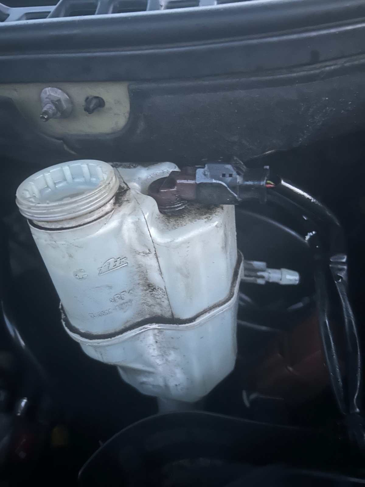

Having an odd issue. I’ve recently replaced my
Clutch, DMF, master and slave cylinder. I’ve now gone to pressure bleed the system but getting nothing but air through it.
I’ve traced back from the slave until I find a point where the fluid is, however confusingly the fluid has turned out to not be leaving the reservoir. When I cover the hole and let the pressure build, on releasing the cover on the whole to pressure released and it spits fluid, but then stops.
What could be causing the fluid from not leaving the reservoir to feed the master and so on? Checked the brake and the fluid flows fine through those.
Any help would be appreciated!
Also the reservoir is above max with fresh fluid
Thank you.

Hi Paul,
Thanks for the reply. The system on my car seems to be clip and pipe. I have tried the suck method and still only getting air, also tried the furiously pumping the pedal method and again just air.
Just very confusing as the first step of the fluid coming out of the reservoirs without anything else attaching to it doesn’t seem to happen. I’ve just never seen a situation where I cannot get the fluid from the reservoir to go into the master!
Overall very confusing!

If you shine a torch in the side of the reservoir can you see the fluid level above the clutch outlet ? With the clutch pipe disconnected at the reservoir does fluid run out under gravity - if not then try poking the hole to see if it is blocked. Beware that it does not take much loss of fluid in the reservoir to drop the level below the clutch outlet and the reservoir will have 2 sides to it so a brake leak does not stop all 4 brakes losing fluid, only 2 - I found this on our Cactus when bleeding the clutch and had to start again as air was sucked through.

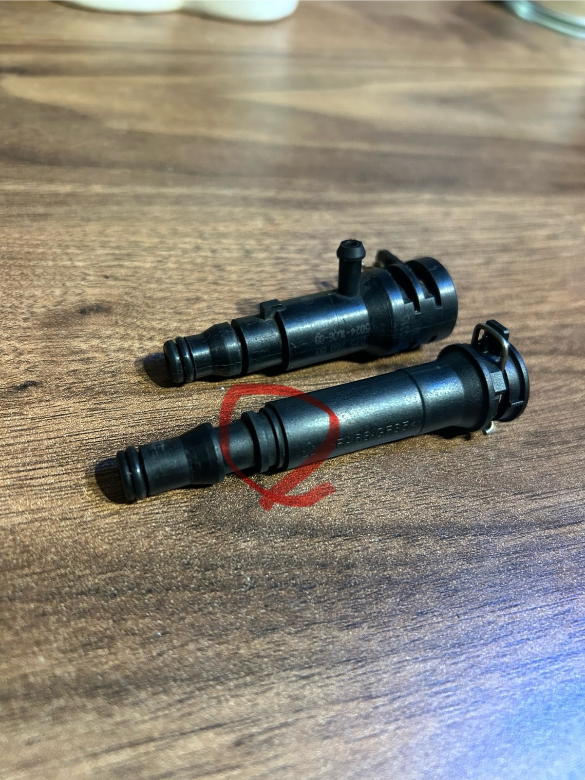

Thanks for the reply. Based on that I thought I’d better get a vacuum pump as my bleed kit doesn’t seem to be doing the job.
Started from the reservoir and after getting some air out I managed to get the reservoir to flow out under gravity (all be it for a few seconds as the level dropped).
Moved to the bleed hole and followed the process, and notice my vacuum pressure was only lasting a few seconds once I stopped pumping, getting spitting of very little brake fluid coming out.
Stripped out the bleed hole connector, and the connector connecting to that and inspected them. I have a feeling that the red circled area is missing an ‘o’ ring. So I will get a pack tomorrow and try again. I cannot see anything else that would cause vacuum pressure to be lost.
Thank you.
