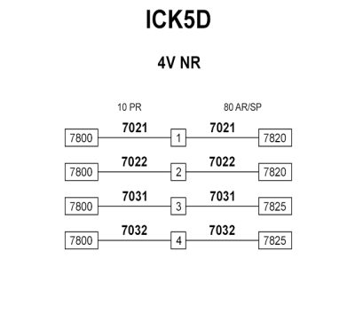

Here you go:
7825 is the rear right Wheel Sensor.
7800 is the ESP ECU
7032 is the Right Hand Rear Wheel Speed Signal Reference on Pin 1 going to Pin 37 of the ECU via the harness interconnections.
7031 Right Hand Rear Wheel Speed Signal on Pin 2 going to pin 22 of the ECU via the harness interconnections.
These go back to the ESP ECU via the 80 AR SP main harness and the ICK5D interconnection.
Main Wiring Diagram
Close up of Rear Right Wheel Sensor
Wiring Harness 80 AR SP
The wheel sensor wiring then connects with ICK5D under the rear seats as shown:
Here is the 4 pin ICK5D connector showing the wheel speed sensor pins in the interconnection: It should be a black 4 pin connector (not 6 pin as shown on the diagram - but can't be sure - you know the French!)

Will try to get my hands there as soon as possible. When ignition on, should I see any voltage on abs sensor pins? Or sensor sends signal to the ecu?
x 6963
Re: 2016 C4 Picasso Abs, esp, parking brake and tyre inflation monitor faults showing
There are 2 types of rear wheel speed sensor according to options (semi automatic parking) but pin 1 contains the sensor supply and pin 2 contains the data stream.

Will check at the sensor if I have anything on pin1. If not then will check under the seat connection.

Checked continuity from connector under the seat to sensor - yellow wire dead. One new wire later all good now.
Thank you Marc for wiring diagram and harnes location.
