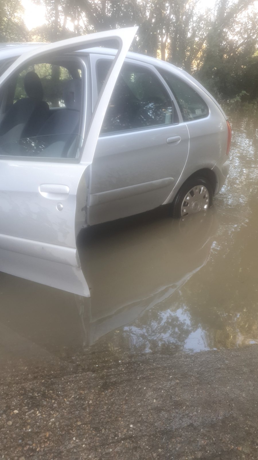

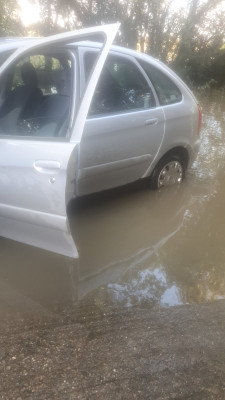

Got caught in flood water had to be recovered stripped the injectors out the way and spun the engine over by hand out came the water, 20 mins later it fired back into life and has been running fine since.
Low air duct, i need a mod any ideas.?
Went for a swim
Went for a swim
:-D

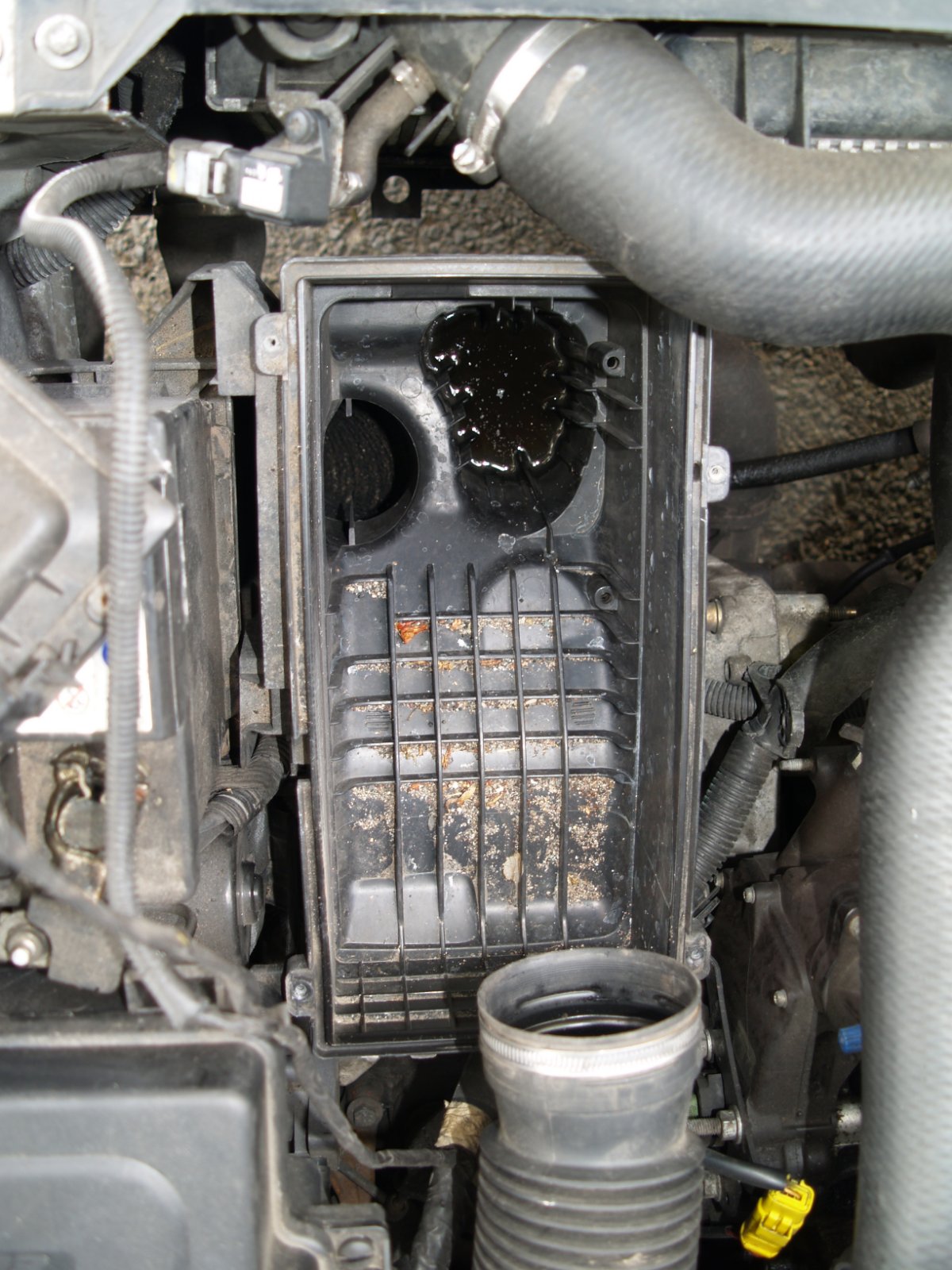

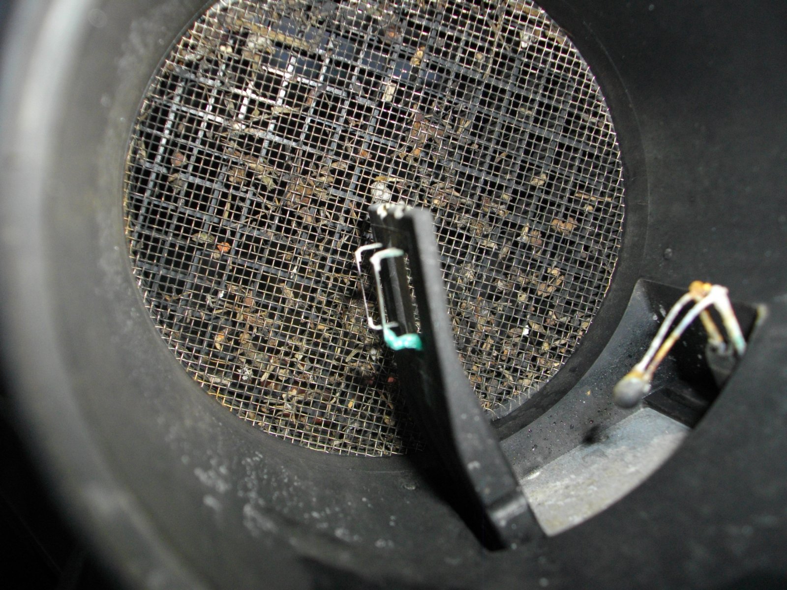

Check your air filter - I had similar when my wheel arch liner exploded and the intake sucked a lot of spray and muck from the verge in.
Filter was soaked and the housing full of water and grit. MAF was ruined too.
Air filter housing
Air filter housing
MAF
MAF
