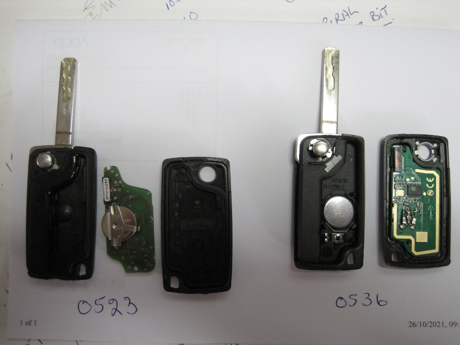

I've attatched a photo of the keys opened and labelled. Obviously a key has been replaced at some time , could there be a date code on the plastic shell or cicruit board so as I could figure out which is the oldest and get that one
The transducer coil thingy in the 0532 key has a small sticker on it "245 Coilcraft " . Could that be an aftermarket one. ?
I thnk if so, then it would be a replacement.
Ideas ?

I have seen the 'coilcraft' sticker on genuine keys before so that one is likely genuine.
That's not to say the other one isn't genuine, part numbers get updated & manufacturers change, it may have been replaced at some point.

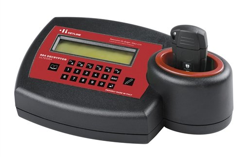

As for the not being able to clone, i've yet to see a key reader/cloner machine that is not able to accommodate regular sized remote keys, They are usually similar to the one below. Is he charging you extra for the transponder code extraction by any chance? How on earth would you copy chips from keys that are imbedded in the key head or in the case of the older Ford keys you would have to destroy the original get to get at the chip to clone it.
