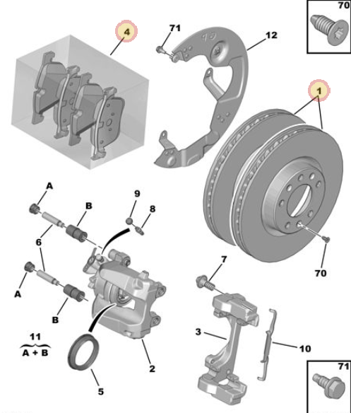

Thanks Richard. With the Vin number is it possible you could tell me which version of disc and pads I need on my car please ? Its coming up with 2 size options when I enter my reg in to sites.
Here you go:
Front Discs: OEM Original part 9805961480 for the kit, £78.76
Note that the original disk kit seems at present to be cheaper than the usually cheaper alternative below!
Or PSA recommended Cheaper: 1667851280, £100.43
These are: DIAM 283 EP 26
Front Pads:
OEM 1609898380 £103.19
PSA Recommended Cheaper: 1619791080 £51.78
Prices quoted as of this post and include VAT, direct from your Citroen retailer.
If you need rears, let us know.
