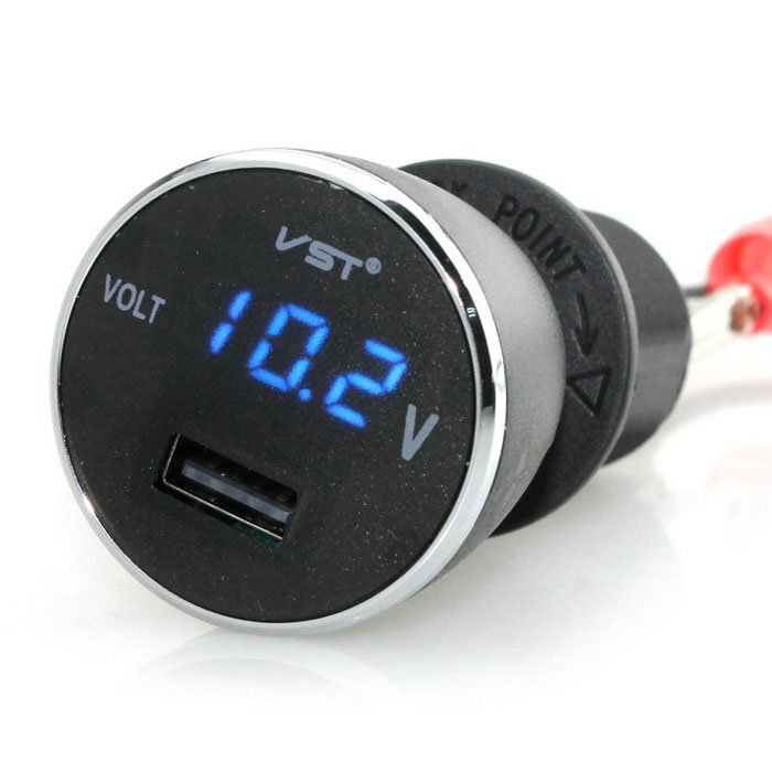

Try connecting a voltmeter to the cigar lighter socket and place it where you can see it when driving. It should read around 14.4 volts but if it varies much from that when the fault occurs it might help with the diagnosis. If it drops very much when the fault occurs it will be a general supply fault, if not it will be an individual unit supply that's failing.
If it is, you could try connecting it to different supply feeds maybe starting at the fusebox.

These are cheap-ish and easy to get hold of.
Not this particular one of course.
I had one in the C5 when my alternator started to fail. Broke it though.
Another posher one has appeared in the Civic - my son's to charge his phone more than anything, despite there being a dedicated USB port.

Not seen one of those - but then I don't get out much.

Me neither but the internet is a useful resource - bought mine from eBay and Amazon, as with so many things.

Never come across one on 'tinternet but then I haven't been looking for one - useful though!

There was one stuck in the cigar lighter when we bought the MGB. I transferred it into the 308 to keep an eye on the voltage produced on the overrun.
Over the last 12 months the first digit (normally displaying a 0 or a 1) has gradually lost all the segments of the display but it's still useable - you just have to use your imagination to add the most likely first digit!
