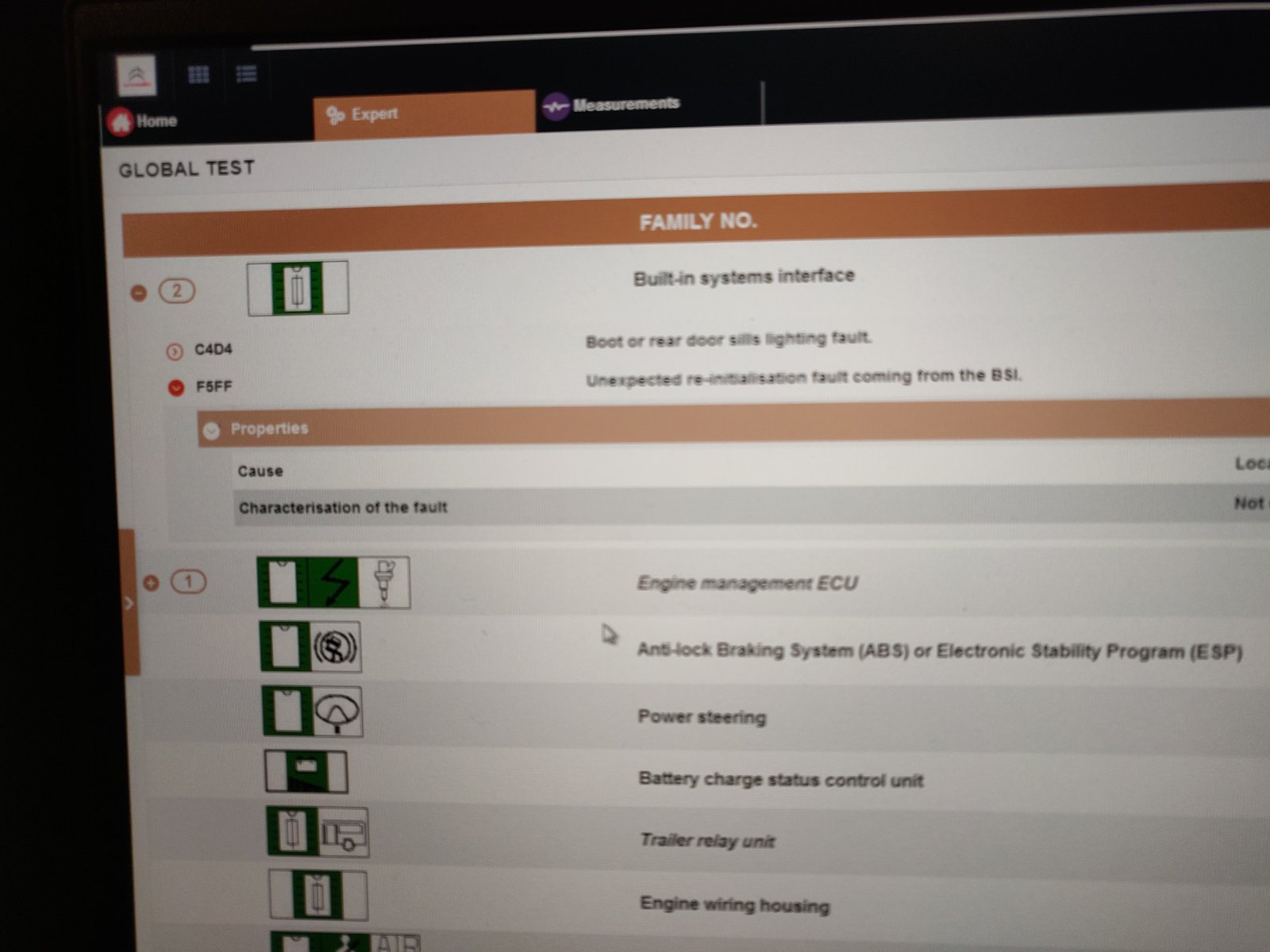

There was two faults in the BSI and one in the Engine ECU. The one in the engine ECU concerns me as I somewhat think it has something to do with the weird behavior. I just don't know what could cause this problem.
Here are the errors:
I hope some of you guys know what it could be and maybe some things I could try to narrow down the problem.

Do you have the VIN of the 2009 C3 please - I'll have a look at the specific fault code.

Re: Central locking error? Car locking randomly
Ok, so it is having issues reading / handshaking with the key.
So if you have followed the reinitialisation procedure part in the BSI reset here:
BSI Reset / Battery Disconnect / Reconnect Procedure
Then check the fob battery. If it isn't working, then the fob itself may be damaged (dropping it on hard surfaces can cause solder joints to crack). I'm assuming you haven't been reprogramming keys or trying to download BSI software, so the fob is my guess at this stage.
| Fault Code: | U0167 |
| Description of Fault: | CAN network: Reading of the engine immobiliser code impossible. No communication: Reading of the engine immobiliser code impossible |
| Conditions for Fault to clear: | Reinitialisation of the diagnostics in after sales only. |
| Downgrade Modes whilst Fault is active: | None Listed |
| Symptoms: | Starting problem |

Well I would take it back and report the same error - as now you have mentioned the fact that they were updating the software, it is possible that it has not been completed properly. They should know that software downloads can take several attempts - especially on the BSI. They should also have checked for correct operation afterwards, which they don't seem to have done given this specific fault code.

Diagbox reports if the software update was successful or not & if you go in to the version it will show you the date it was updated & the version number. Im guessing they wanted to try this first before replacing the BSI?
Are you able to have the live data of the locking system to see if something is commanding it?
