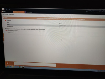

My Citroën C3 from 2009 is having some weird things happening to it. It locks randomly even when the key is in the ignition.
I've tried to localize this problem and I'm sure it's not the remote. I have had the batteries removed from it for 3 weeks and still no improvements. It's still locking on random occasions.
I've tried a BSI reset but no improvement still. Earlier today I scanned the car and tested all the locking and unlocking of the doors and boot.
There was two faults in the BSI and one in the Engine ECU. The one in the engine ECU concerns me as I somewhat think it has something to do with the weird behavior. I just don't know what could cause this problem.
Here are the errors: I hope some of you guys know what it could be and maybe some things I could try to narrow down the problem.

Do you have the VIN of the 2009 C3 please - I'll have a look at the specific fault code.

Re: Central locking error? Car locking randomly
Ok, so it is having issues reading / handshaking with the key.
So if you have followed the reinitialisation procedure part in the BSI reset here:
BSI Reset / Battery Disconnect / Reconnect Procedure
Then check the fob battery. If it isn't working, then the fob itself may be damaged (dropping it on hard surfaces can cause solder joints to crack). I'm assuming you haven't been reprogramming keys or trying to download BSI software, so the fob is my guess at this stage.
Fault Code: | U0167 |
Description of Fault: | CAN network: Reading of the engine immobiliser code impossible. No communication: Reading of the engine immobiliser code impossible |
Conditions for Fault to clear: | Reinitialisation of the diagnostics in after sales only. |
Downgrade Modes whilst Fault is active: | None Listed |
Symptoms: | Starting problem |
Suspect Areas: |
