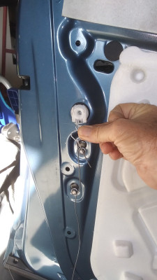

Huge thanks to Marc and Zane2g2 for the very helpful guidance on the mirror indicator not working on my 2015 C4GP. First - I tested the light before getting a new one, and yes, it was working. Before reading above I removed the door panel. No access to the right area though. What wiring I could see was in good condition.
Then I read above and tackled the mirror itself. Had already removed the mirror once by undoing the bolt inside the door, but couldn't see any broken wires. Then Zane2g2 mentioned Tork screws to remove the mirror. What? Where? Then I found them under the swivel part of the mirror. Took them, out, and whaddyaknow, two broken wires as described above. I was inclined to blame the harness in the door jamb which was going to be difficult to check, but now don't have to. Repaired the wires and all working again. I can't thank you enough for the great advice on tackling this job. I'd hate to think what Citroen might have charged. Most of the time I spent on this (couple days) was researching and pulling off the door panel and tearing hair out. Once I found this post, the actual repair only took a about an hour and I wouldn't have had to touch the door panel. I also found a good Youtube video on pulling the mirror apart. It all helped.
I've included a photo of the broken wires, plus a photo of a tricky door trim clip about an inch or so in from the side edge of the door. It was not a standard pull out clip refusing to let go. Looked inside in what small gap I could make to find a clip held in place by a wire circlip similar to that used in the good old days to hold a manual window winder handle on. I got a length of wire, formed a hook, pulled down on the wire clip, and everything just came apart. Luckily I had resisted the urge to just pull harder on that clip. All other clips popped out nicely using a door trim removal tool, and no clips broke.
Alll in all a very satisfying job. Thanks.
