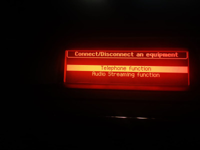

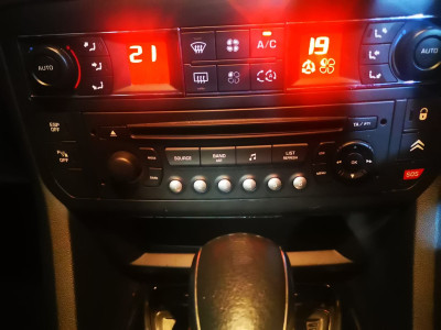

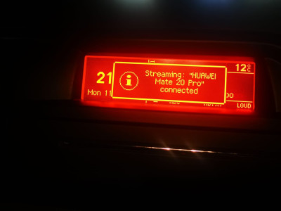

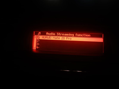

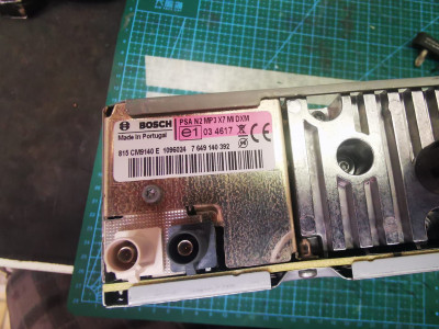

Hi all! I got a lovely 2010 C5 Exclusive with an RD4 today! It has the non-sat nav audio system (matrix display) and was wondering if your collective knowledge could help me out a little! I'm trying to stream music from my phone via Bluetooth. I have the phone all connected, and it is silent as if it's playing, but when I press the "mode" button on the headunit, nothing happens. Likewise if I put a USB drive in the socket!
Any ideas, please? I tried making calls, but even though it says there's a call in progress on the matrix screen, the car doesn't switch from radio to the phone. I've included some photos below!

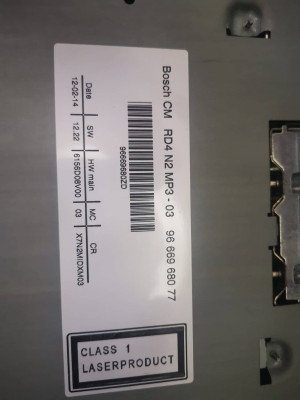

Is this the original RD4 head unit and display or have you changed it at all for an RD45? Pop your VIN up for me (automasked on post submission) it will help me determine what was fitted at factory.

I only got the car yesterday, but when I removed it, the date was 2014 (the car is a 2010) so I can only assume that a previous owner has replaced it. (I took another photo!) Here's the VIN: VF7**************[VIN obfuscated, can be read by forum staff] Thank you!

Ok, so your C5 was originally shipped with the RD4 system and a telephone interface kit (bluetooth) separately and wired behind the dash.
So maybe somebody has replaced the display at some point given the build date of your car. You can always try unpairing AND deleting the phone from both the Head Unit and also the Mobile (unpairing is not enough - it must be deleted). Then restart the phone and the car and try pairing up again and make sure you select all the profiles you want on the phone when the bluetooth connection is made.

Thank you Marc! I'll try another phone, My daughter has an older S7. I tried unpairing and deleting and it didn't work. I even tried the reset procedure for the ECU (all that did was throw my clock back to 2007!) I found the bluetooth module behind the odds and ends cubby, unplugged that and my phone wouldn't even connect (as expected) so I know everything is all there. The phone is silent when making calls and connected (I called the speaking clock!) and as you can see, it shows on the matrix screen that a call is in progress. It's simply that the source button doesn't work (although if I DO press it, the FM radio/song/station information that scrolls along the bottom of the display resets to the start of the scroll). Is there a physical connection on the rear of the unit that connects directly to the bluetooth module ( aside from the grey MP3 one) do you know?

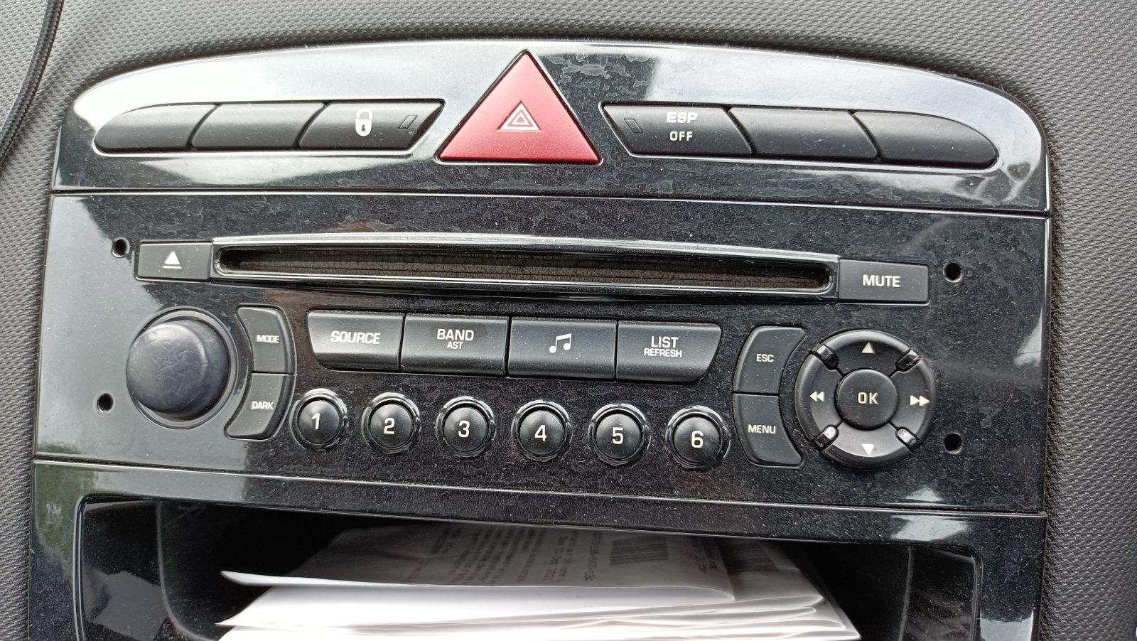

Re: C5 Bluetooth Oddity
The unit in the photo in the original post is an RD4. The RD45 has a MUTE button to the right of the CD slot
