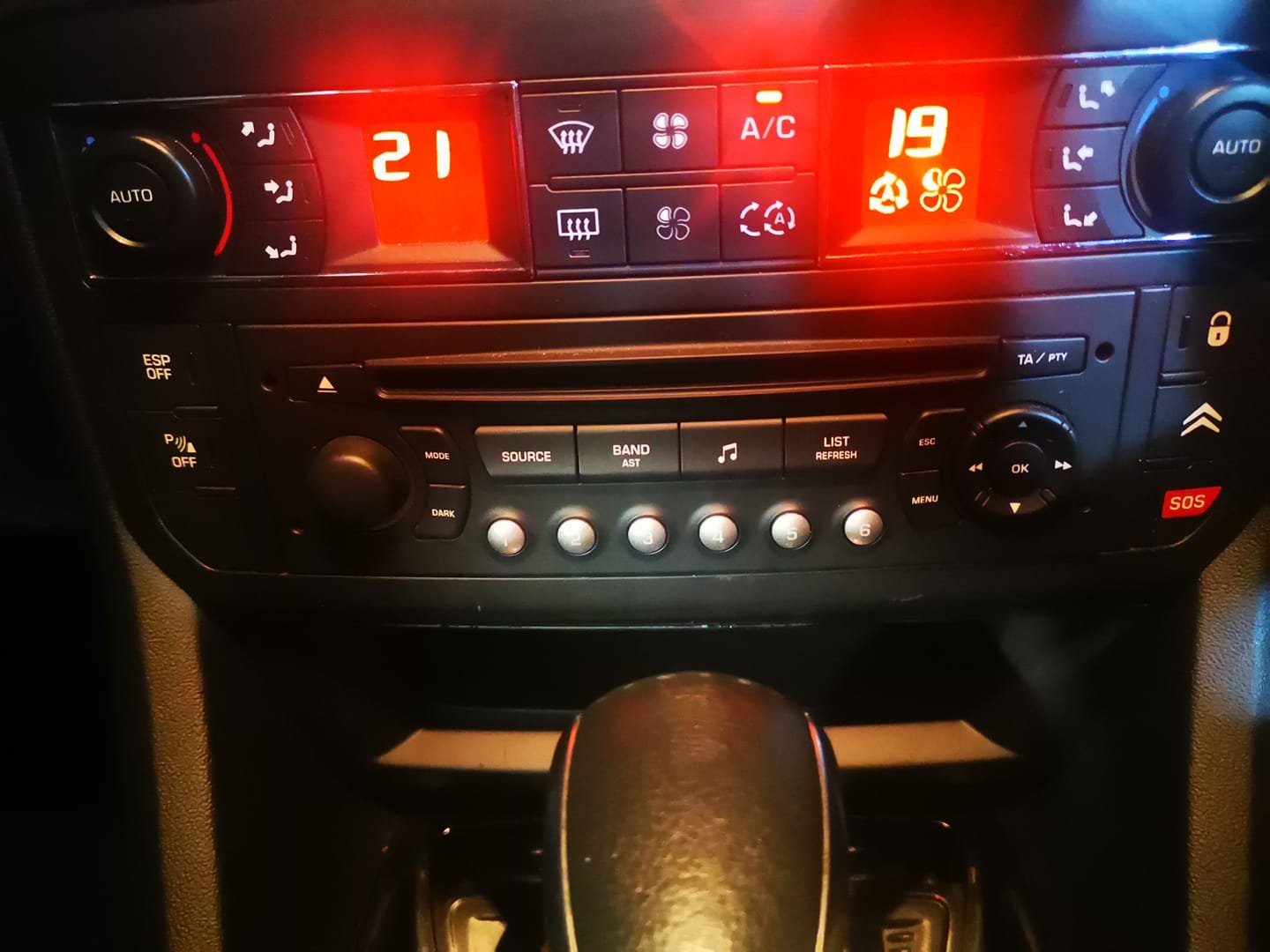

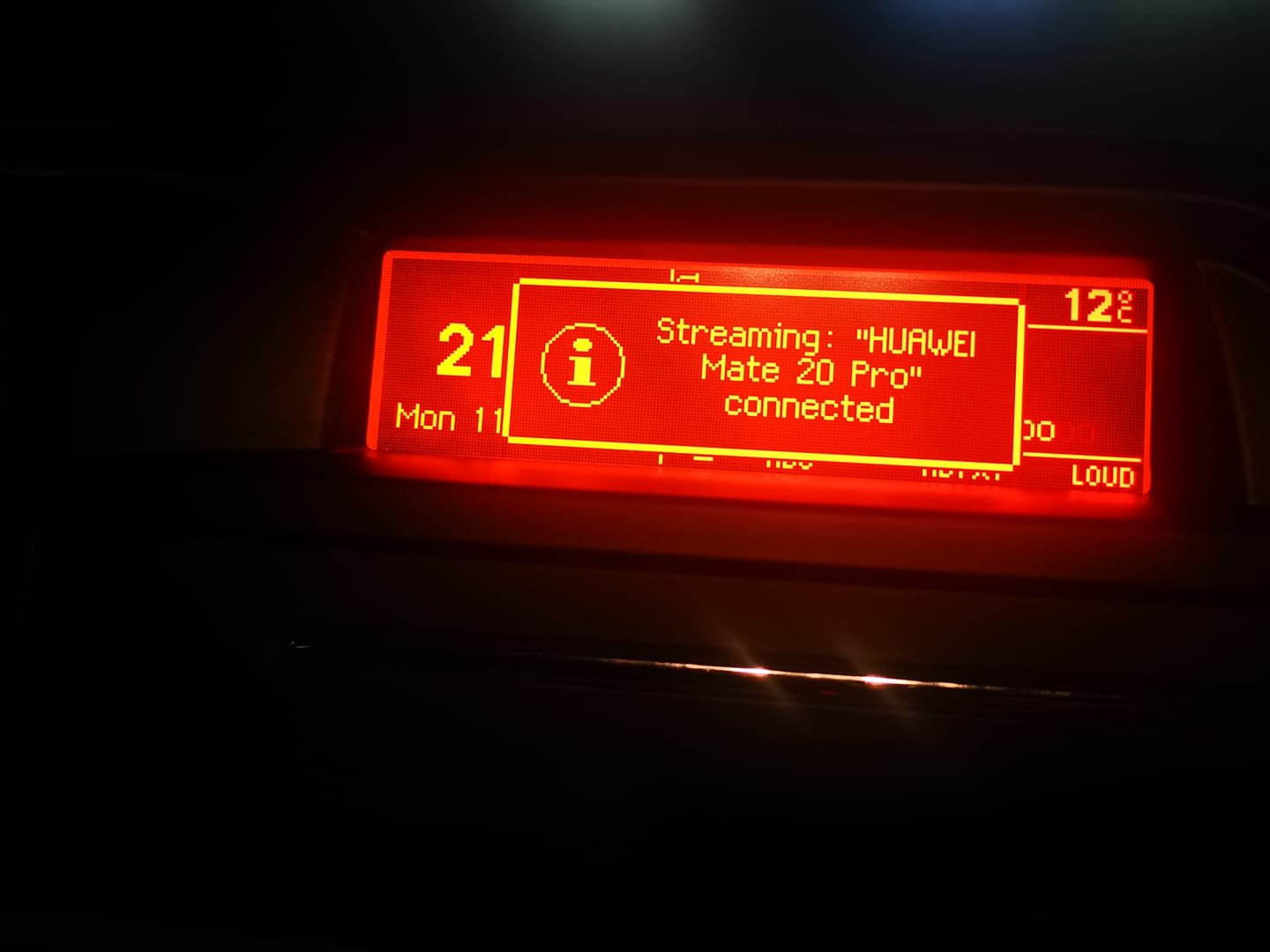

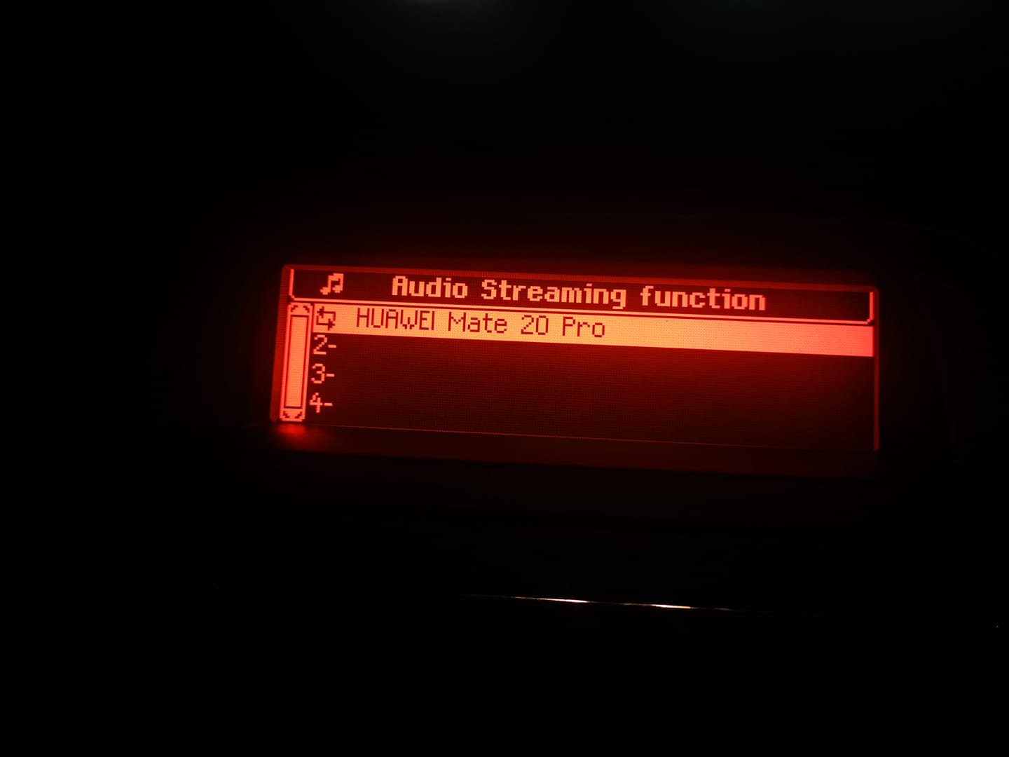

Hi all! I got a lovely 2010 C5 Exclusive with an RD4 today! It has the non-sat nav audio system (matrix display) and was wondering if your collective knowledge could help me out a little! I'm trying to stream music from my phone via Bluetooth. I have the phone all connected, and it is silent as if it's playing, but when I press the "mode" button on the headunit, nothing happens. Likewise if I put a USB drive in the socket!

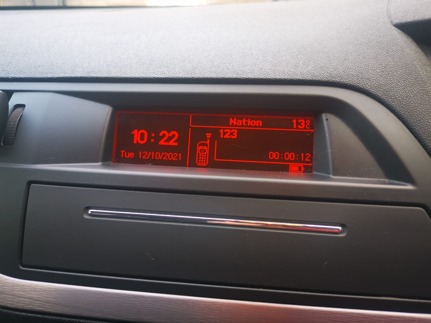

Any ideas, please? I tried making calls, but even though it says there's a call in progress on the matrix screen, the car doesn't switch from radio to the phone. I've included some photos below!

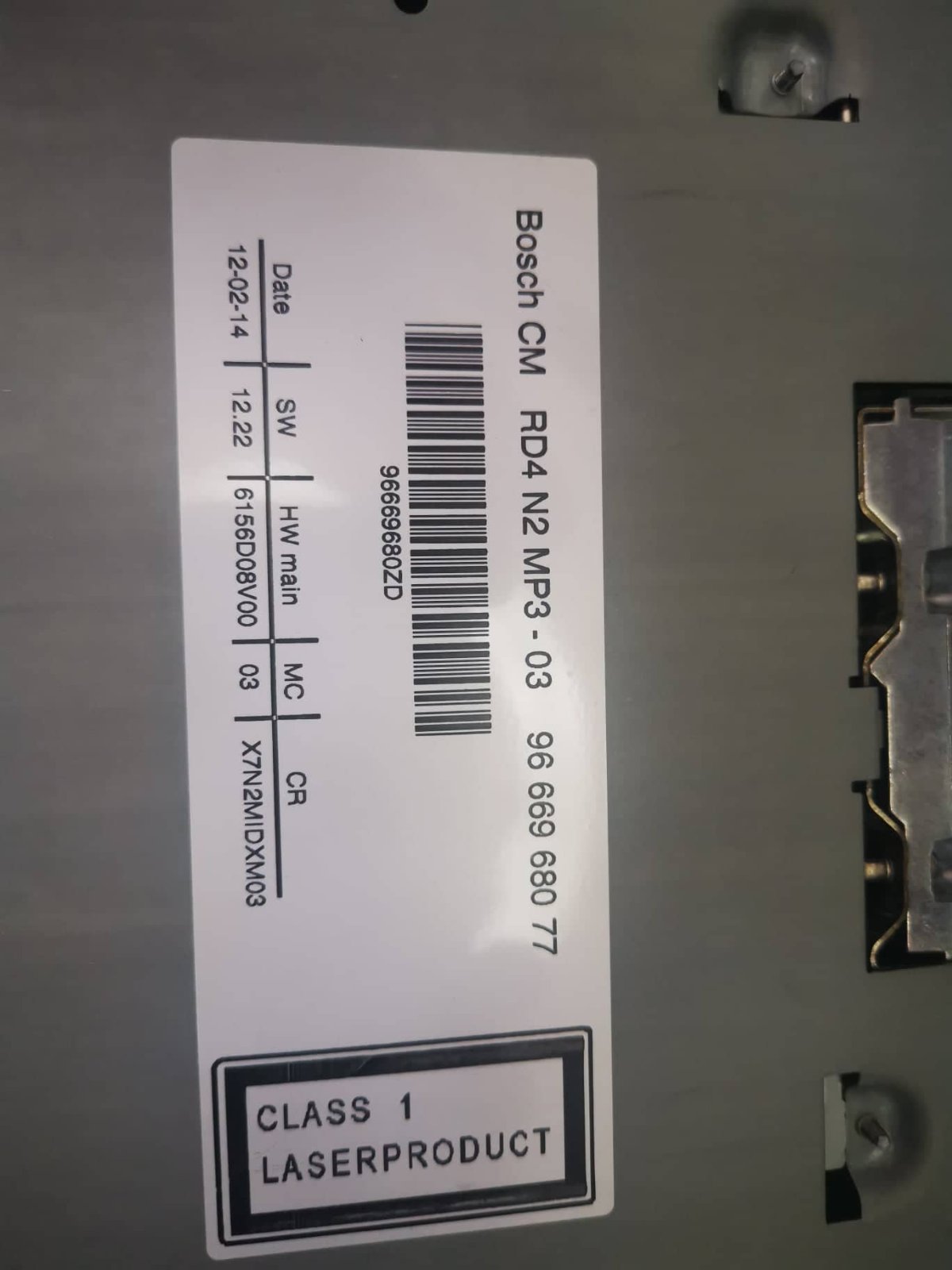

I only got the car yesterday, but when I removed it, the date was 2014 (the car is a 2010) so I can only assume that a previous owner has replaced it. (I took another photo!) Here's the VIN: VF7**************[VIN obfuscated, can be read by forum staff] Thank you!

Thank you Marc! I'll try another phone, My daughter has an older S7. I tried unpairing and deleting and it didn't work. I even tried the reset procedure for the ECU (all that did was throw my clock back to 2007!) I found the bluetooth module behind the odds and ends cubby, unplugged that and my phone wouldn't even connect (as expected) so I know everything is all there. The phone is silent when making calls and connected (I called the speaking clock!) and as you can see, it shows on the matrix screen that a call is in progress. It's simply that the source button doesn't work (although if I DO press it, the FM radio/song/station information that scrolls along the bottom of the display resets to the start of the scroll). Is there a physical connection on the rear of the unit that connects directly to the bluetooth module ( aside from the grey MP3 one) do you know?

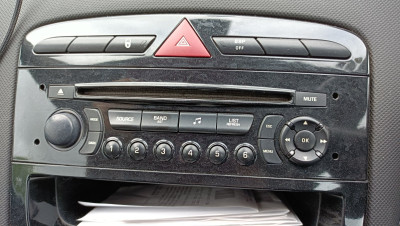

The unit in the photo in the original post is an RD4. The RD45 has a MUTE button to the right of the CD slot

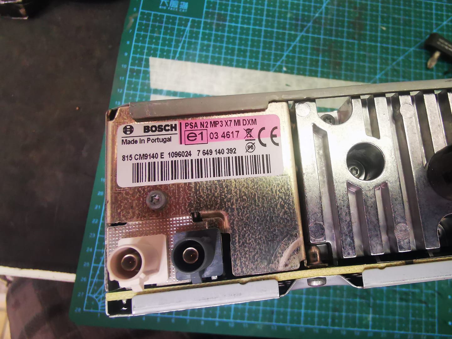

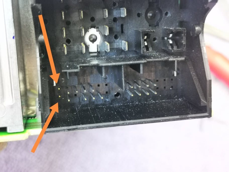

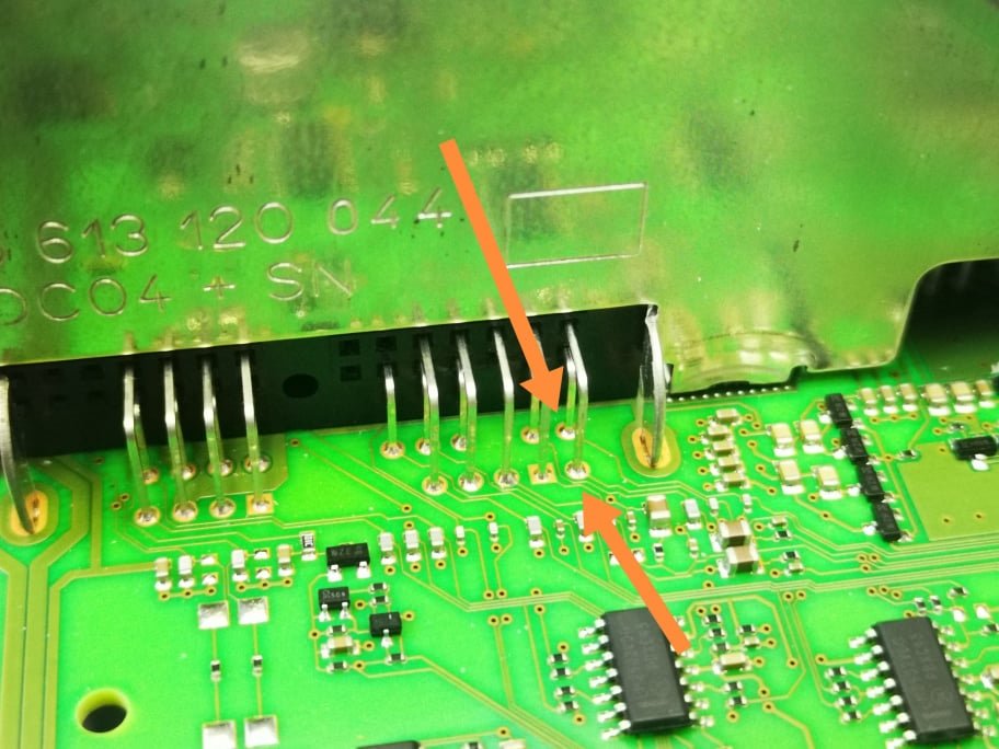

Thanks! I'll do that if I go down that route! Well..here's a little update, but it only serves to ask MORE questions! I looked at the pins and compared them to a pinout diagram. There seems to be 2 extra pins that have been cut off. They're soldered to the PCB, but are outside the main pins (numbered) and don't seem to connect to anything! Any ideas? When I looked initially, I thought they might have been the aux2 audio pins (pins #1 and #7) which were used for the bluetooth, but the plastic has small numbers on it that say the other 2 pins are 1 and 7...
My brain is melting, but I'm grateful to everyone!
- x 6948
Re: C5 Bluetooth Oddity
Ignore those, it's by design. Here is the Pin-Out for the RD4 system for CD Changer and Hands Free Kit, but without HiFi Option:
