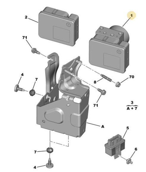

So as you can see, the complete hydraulic block item (1) with attached ECU can be purchased new or an exchange block can also be purchased. Both these would need configuring though.
Peugeot Original Brand New Complete block and ECU, part: 4541TH £1,448.29
Exchange Block & ECU, Part: 1682609380, £1,407.00
Alternatively, if the block is functional and the ECU is suspect, then this can also be replaced individually item (2).
Brand new OEM ECU only, Part: 4542AG, £958.01
All prices inc. VAT and correct as of time of post.
So at least you have the correct parts for the options shown.
