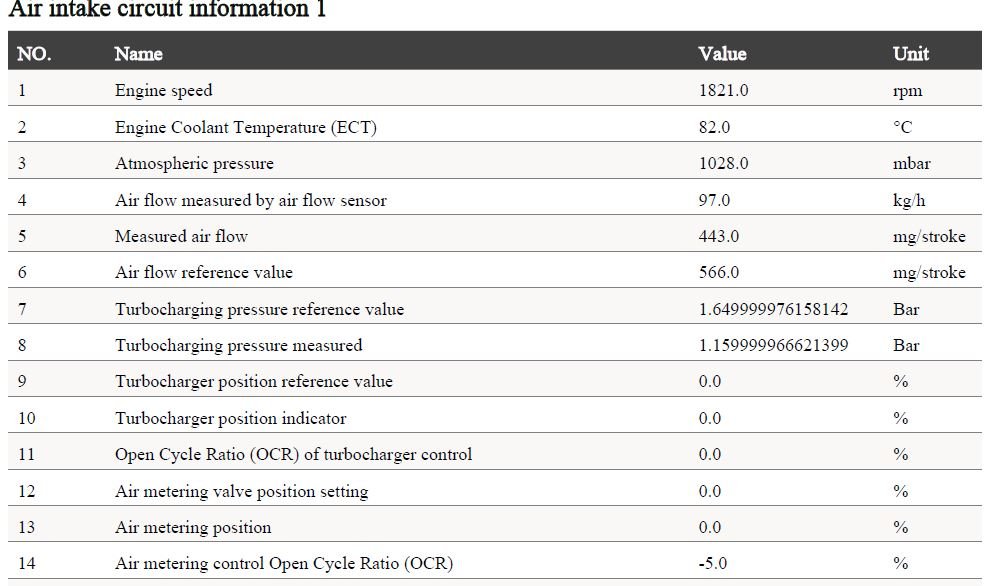

I have Freeze frame data from each of the errors
P1496- P1497- P2562- P2563- I have gained ECU data for my car year 2016 at around 1500rpm Also got data from an identical working Citroën car but from year 2015 below. You can compare both cars. Here is another live data snapshot at higher revs from my car.

Turbo charger position is showing some odd parameter values. Is this likely the issue?

Looks like the output is stuck in one position - which might be the sensor or it might be the turbo. Don't know the exact configuration on these units, on the earlier ones the VNT mech was external and you could see it move when the engine was started and also push it manually to see how it felt. Have a look and see if this is same on yours. If so you could try pushing it up and and down whilst watching the live data to see if it changes, or even to see if you can move it. Given that it is reading 70% seems more likely the unit is broken rather than a wiring fault, as I would expect that to give either open or closed reading.
