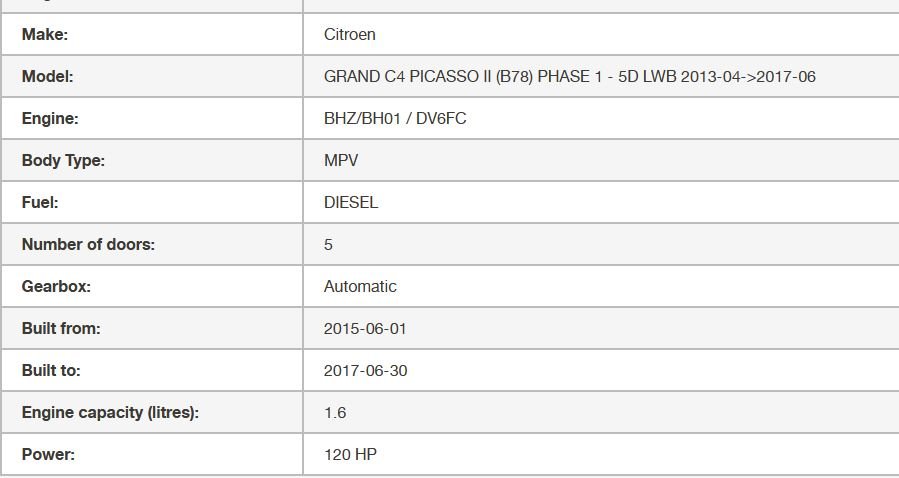

Hi Richard, I have changed both MAP sensor and turbo boost solenoid but same error codes exist having deleted the errors prior to changing. As for the engine type the logbook shows variant as BHZ and chassis has BHZ letters too. Also screenshot from Haynes online shows engine type. I will get some live data readings today.

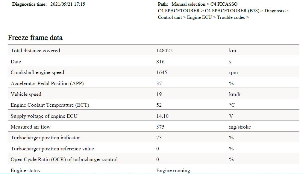

I have Freeze frame data from each of the errors
P1496-
P1497-
P2562-
P2563-

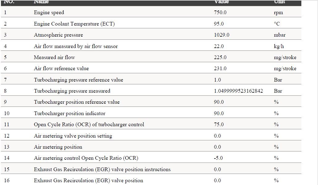

I have gained ECU data for my car year 2016 at around 1500rpm
Also got data from an identical working Citroën car but from year 2015 below. You can compare both cars.
Here is another live data snapshot at higher revs from my car.

Turbo charger position is showing some odd parameter values. Is this likely the issue?

Looks like the output is stuck in one position - which might be the sensor or it might be the turbo. Don't know the exact configuration on these units, on the earlier ones the VNT mech was external and you could see it move when the engine was started and also push it manually to see how it felt. Have a look and see if this is same on yours. If so you could try pushing it up and and down whilst watching the live data to see if it changes, or even to see if you can move it. Given that it is reading 70% seems more likely the unit is broken rather than a wiring fault, as I would expect that to give either open or closed reading.

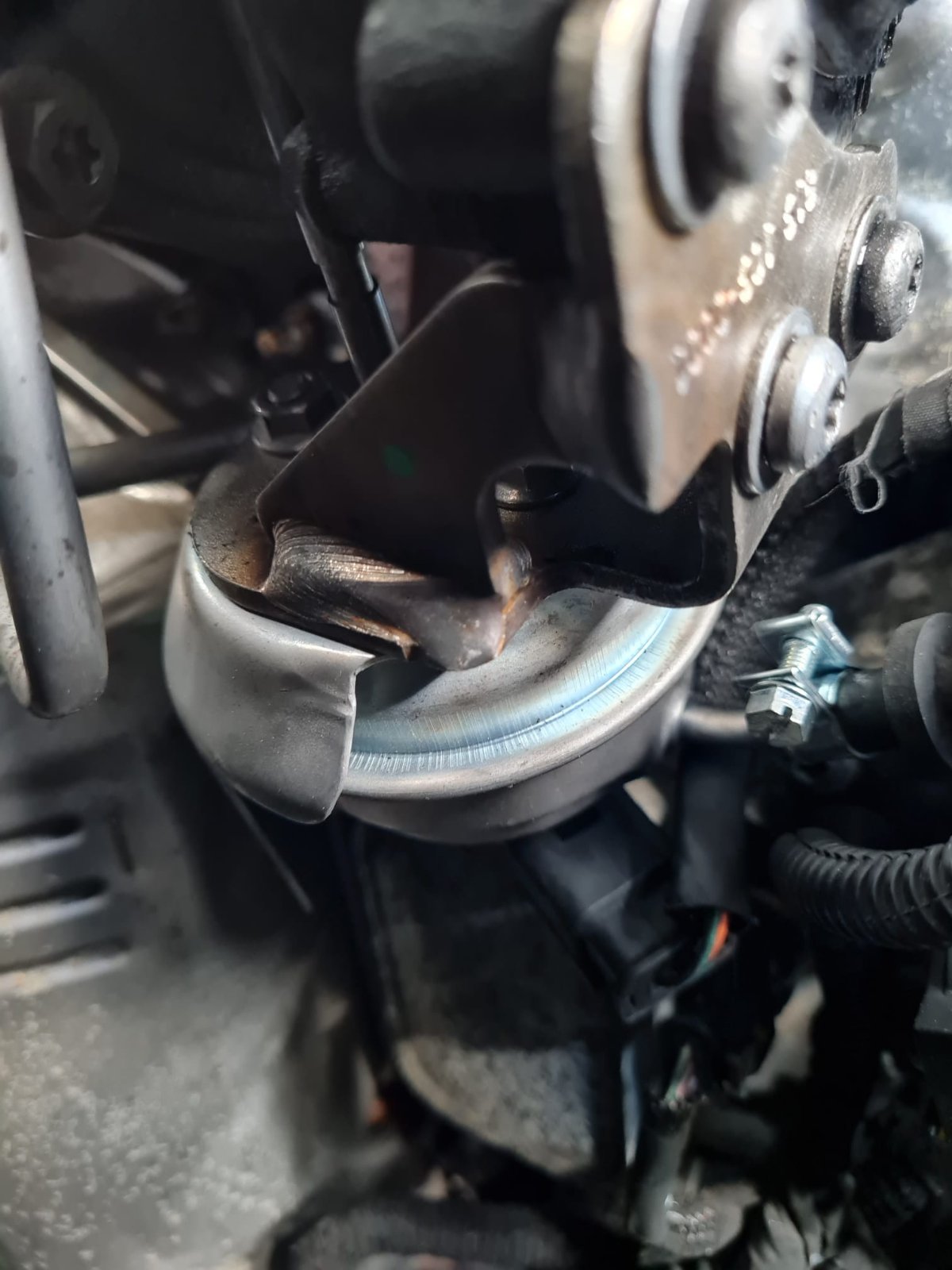

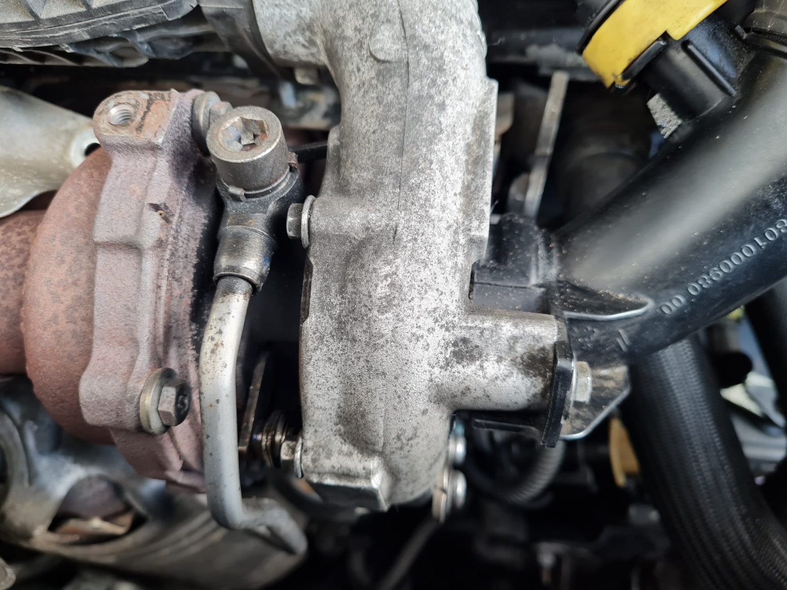

Richard forgive my ignorance but VNT and waste gate are almost the same and you would only have one or the other(see Pic below). As for waste gate, I have replaced this last week with a new one. Should I be sending it back and getting one with turbo at a more costly price? The wastegate rod does move when engine is not started but fails to move when engine is started because of pressure.

Wastegate / VNT sort of the same thing, but they work differently - this is a variable vane turbo so looks like you have replaced the VNT actuator (even if someone called it a waste gate actuator). Presumably the fault was apparent before you changed the unit? Is there actually an electronic unit on the turbo to report the position?
