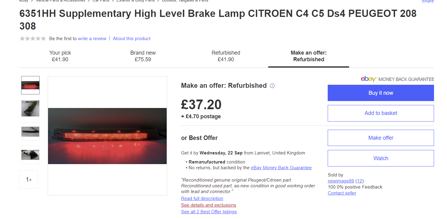

Re: Centre brake light
Try again - there are 3-4 options along the top, depending on which unit you want.
https://www.ebay.co.uk/p/2271780580?iid ... 4&thm=5000

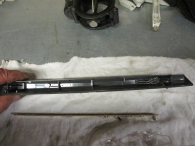

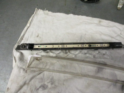

It was a bit fiddly to get apart, you need to take the lens out then the circuit board with the LED's on

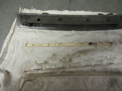

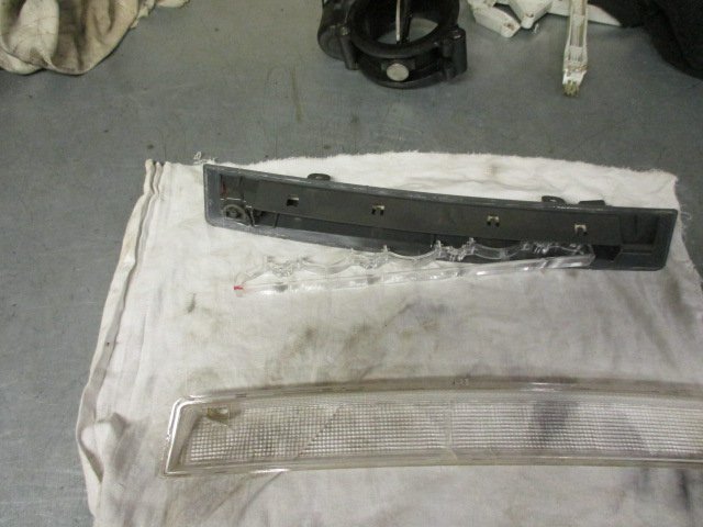

Hi Dean
This was my light coming apart
The lens was held in place with a tiny amount of glue, prised off carefully with a knife blade, then wiggled out the reflector. The circuit board is just pushed into place and the 2 power supply probes go through the circuit board, I pulled it out with a couple of hook tools. Then I desoldered the LED'S from the board , fitted the new ones and tested it before reassembling.
Hope this helps
Steve
