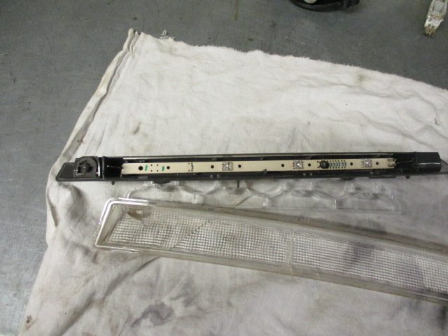

It was a bit fiddly to get apart, you need to take the lens out then the circuit board with the LED's on

This was my light coming apart
The lens was held in place with a tiny amount of glue, prised off carefully with a knife blade, then wiggled out the reflector. The circuit board is just pushed into place and the 2 power supply probes go through the circuit board, I pulled it out with a couple of hook tools. Then I desoldered the LED'S from the board , fitted the new ones and tested it before reassembling.
Hope this helps
Steve

All the above seems like a lot of work, but it is not too bad and a lot cheaper than buying new. ( I am addicted to repairing rather than replacing!).

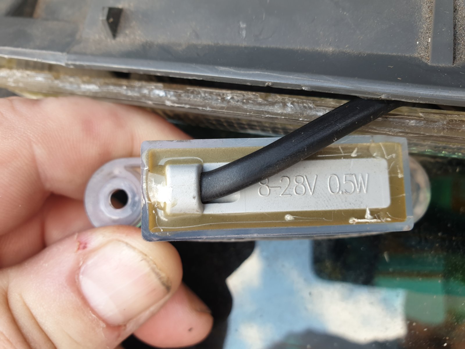

Thanks for that Steve. I've got into the light by prising it slowly apart, as you say, it's glued shut, but inside mine is different to yours. Mine is in three separate clear, sealed units. How do I upload a photo on here? Can't see an icon to upload? Mine looks totally different to your pictures inside? Thanks

cheers steve....check this out.different, the unit is sealed....you can see it scratched where i tried to open it up but i can't seem to get into it

thanks marc, found it now. i'm going to try and get in this first cos i've bought the led bulbs now but will prob end up buying that one.cheersGiveMeABreak wrote: ↑17 Sep 2021, 15:58 Try again - there are 3-4 options along the top, depending on which unit you want.
