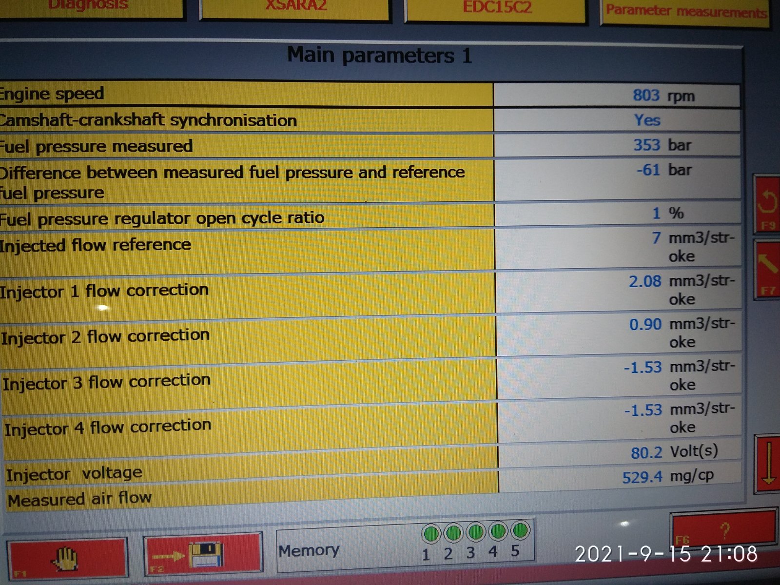

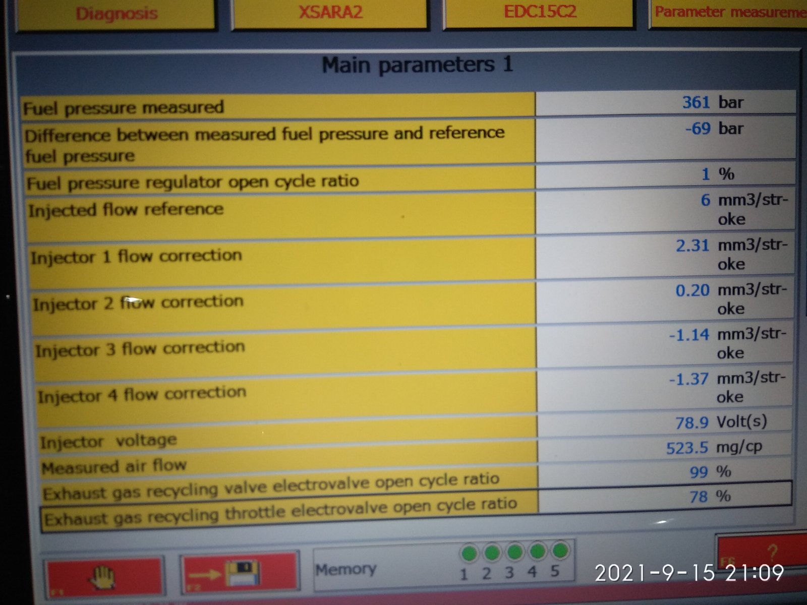

Screenshots...

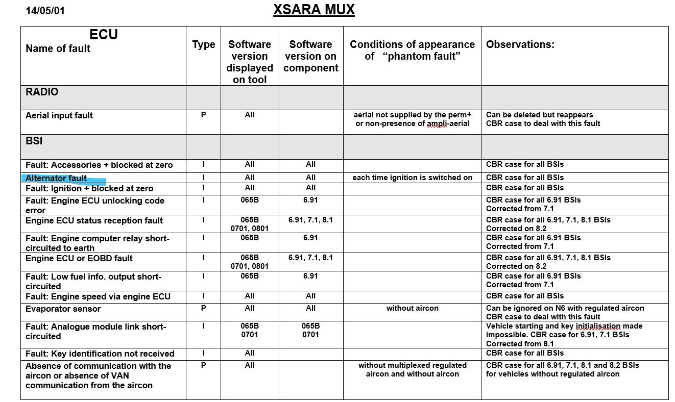

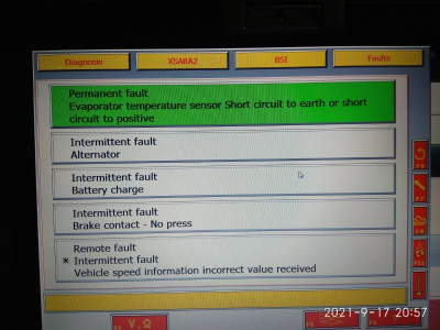

The BSI faults are most likely phantom faults - based on wheeler's reply on page 1 of this thread. So that points solely at the HP regulator being blocked as the culprit?
wheeler wrote: 05 Jun 2020, 13:22 Ignore the evaporator temp sensor, speed info fault & the brake signal fault. They are known 'phantom' faults & will be in nearly every RHY/RHZ engine you scan.
Although before ignoring the brake switch fault just confirm the brake lights are working correctly.
If you had a charging issue I reckon there would almost certainly have been other electrical symptoms, I'd say the fault you experienced would almost certainly be caused by P0190. First off how old is the fuel filter? is this a Bosch or Siemens system?
EDIT: Just checked & it turns out the alternator fault code is also a phantom fault.
Any ideas as to where I go from here?
Edit - should say that P1138 occurred before leaving for the drive.

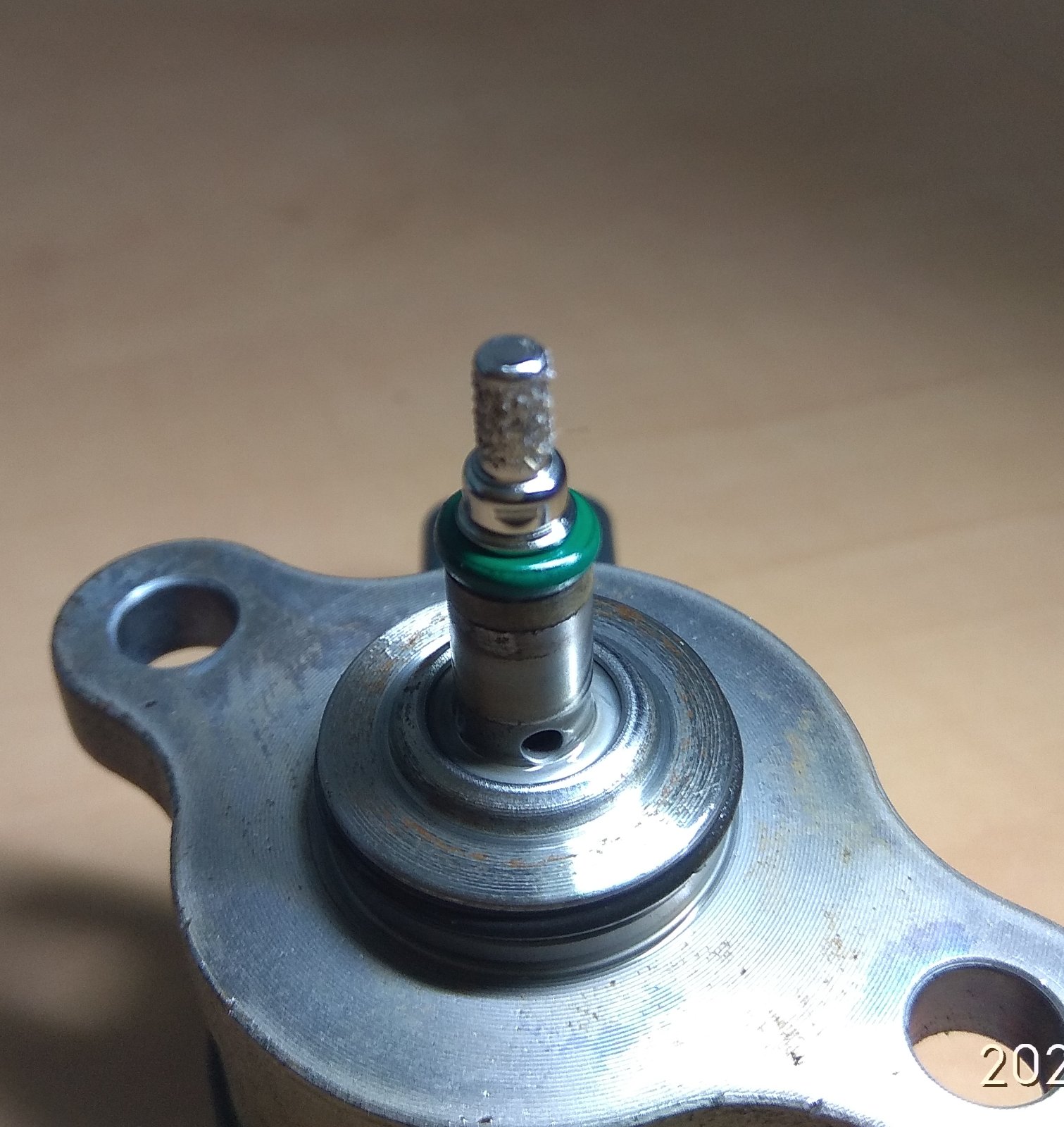

Started stripping down today and the filter on the high pressure regulator has a lot of filings on it.
Can I clean these off?
Would this indicate the failure of the lift pump in the tank which I have now replaced or would it point to the hp pump to which the regulator is attached?
Is there a way to check the HP pump itself?
