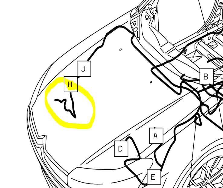

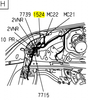

Re: Suspension wont pump up - 2011 C5 (X7) 5 DOOR ESTATE 2.0 HDi 163 PEF ( DW10CTED4 )
There's a technical bulletin if there is no height variation when pressing the height switch to raise or lower the vehicle and it concerns the Hydro-Electronic unit control relay.
It requires testing the relay for electrical supply first of all and it's why I previously asked if there were any fault codes present - as these should be addressed before undertaking the following test, but this would be the next step:
Earth Check (1)
Check the Specific earth points MC21 & MC22 marked on both the electrical diagram and for which the general location is shown on the earthing point map below:
First Check: Check Earth MC21 & MC22 for condition and cleanliness. If these are making contact and are clean move to the next check (2):
Check (2)
Check the power supply between track 1 (B7739) and 2 (M7739) of the 2 way black connector of the integrated hydro-electronic unit using a 55 W test lamp:
(Note Fuse F13 in the BSI in the passenger compartment glove box (RHD) is a 5 Amp that also supplies the Electrohydraulic Suspension ECU).
Refer to the large electrical diagram below - 7739 is the Central Electronic Block Motor.
Check (3)
Integrated Hydro-Electronic Unit Control Relay
Location of Relay (1524):
Shunt the integrated hydro-electronic unit relay between terminals 3 and 5 (at "a"):
Earth Check (1)
Check (2)
- If the test lamp shines brightly: Carry out check 3
- If the test lamp shines weakly or does not illuminate; Check the power supply line between the integrated hydro-electronic unit and its electrical relay and don't replace the relay.
