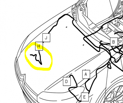

Earth Check (1)
Check the Specific earth points MC21 & MC22 marked on both the electrical diagram and for which the general location is shown on the earthing point map below:
First Check: Check Earth MC21 & MC22 for condition and cleanliness. If these are making contact and are clean move to the next check (2):

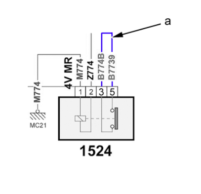

Integrated Hydro-Electronic Unit Control Relay
Location of Relay (1524):
Shunt the integrated hydro-electronic unit relay between terminals 3 and 5 (at "a"):
The relay:

Earth Check (1)

Check (3)
- If the integrated hydro-electronic unit operates: Replace the Relay
- If the integrated hydro-electronic unit does not operate: Check the control line terminal 2 of the electrical relay
The relay:
