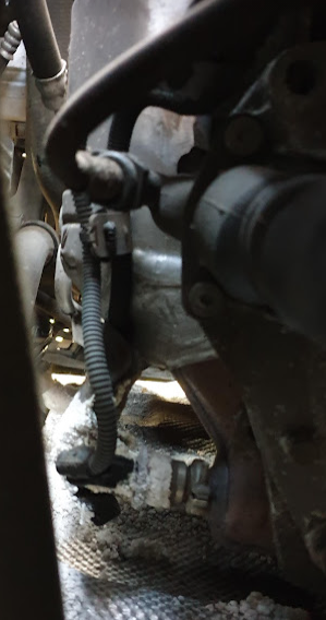

This is similar to what it looks like with the crystilisation and the dips.

Can someone tell me what the grey cloth bag type thing is around the end of the injector a tube goes into it then the injector comes out? mine is solid?

It's insulation to stop the heat from the exhaust melting the plastic urea pipe & also i suppose to help stop the urea freezing at the injector as i dont think that part of the pipe is heated.

cheers it just looked a bit tatty as if it shouldnt be there, :)
