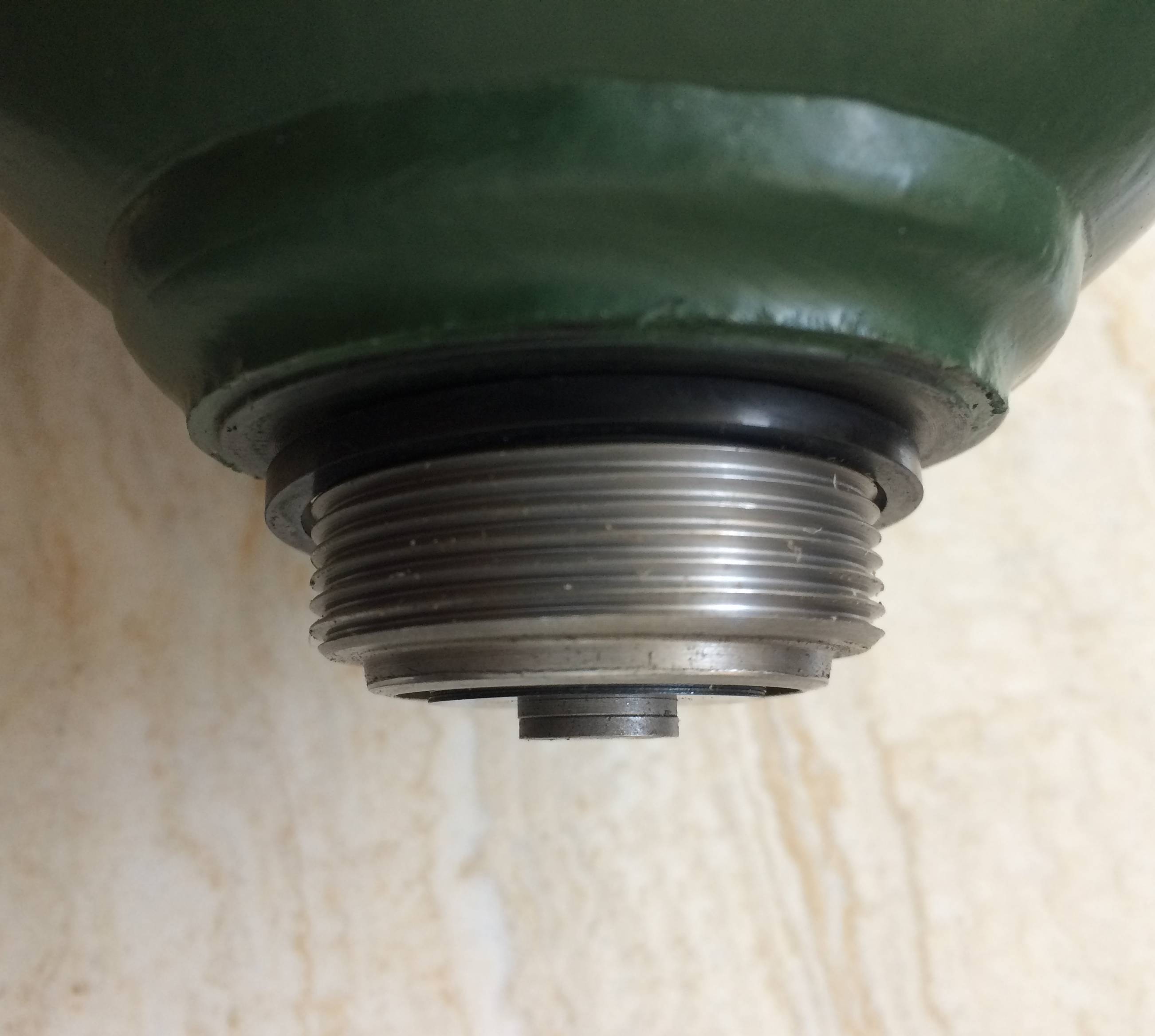

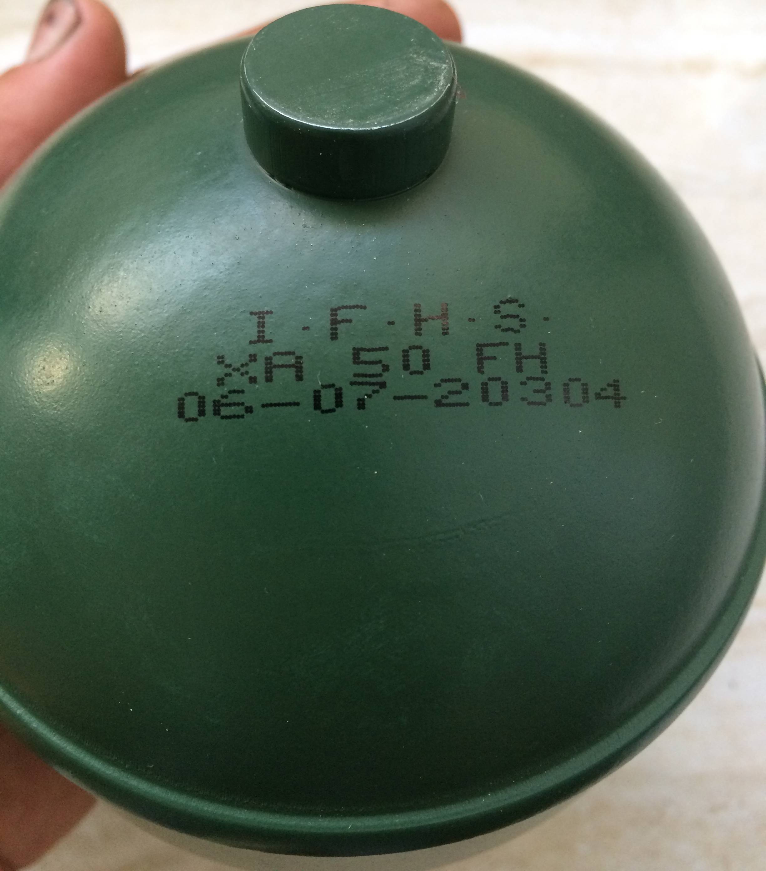

Re: fake I.F.H.S sphere
i found a original ifhs sphere!!
but it is for hydractive models -regarding to ifhs catalog-. can i use it for non-hydractive?
its have good threads and dampers and comes with ifhs box - pack of 2 -
also have spotted numbers on damper
