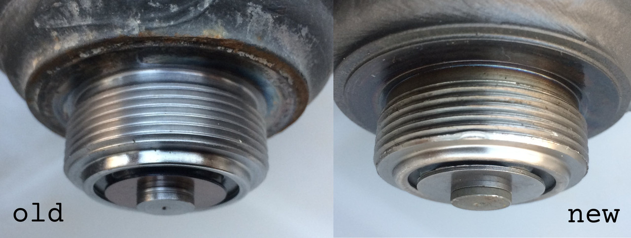

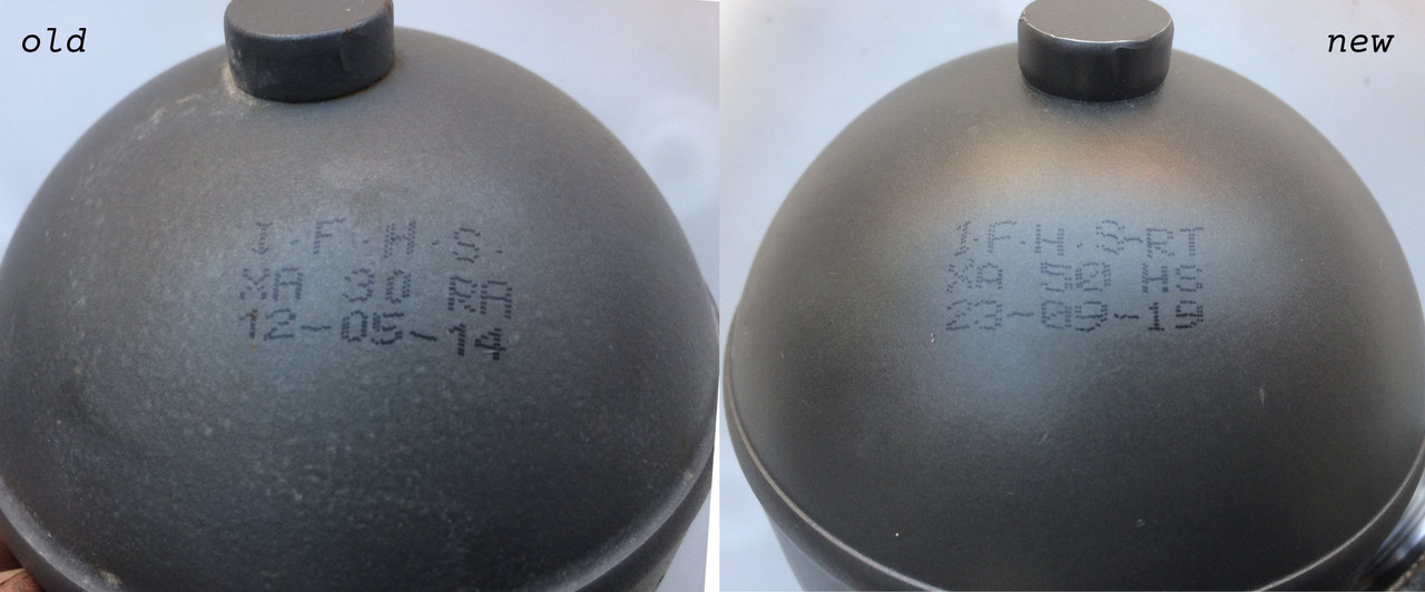

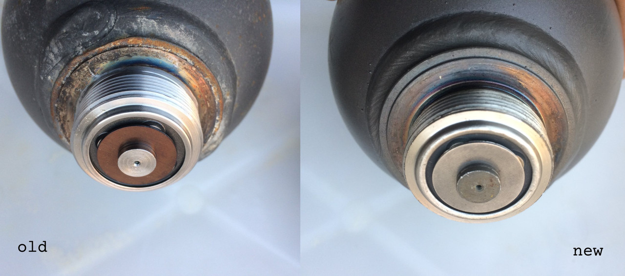

i bought a brand new I.F.H.S sphere but it may be fake one.
as you can see the threads on old sphere are clean but new one have low quality threads
is it fake?
x 1746
Re: fake I.F.H.S sphere
The XA30RA sphere on the left would be for a non-Hydractive Xantia 1.8i, rear sphere, and looks genuine.
I cannot find any listing for an XA50HS in IFHS's listings, or a google reference, but someone else might want to check.
I can see three oddities with that sphere...
- the poorly formed thread
- the very thick stack of outer by-pass washers
- the rough finish on the central damper
IFHS - RT??
More eyes needed on this, but I'd be tempted to send your pictures to IFHS (in Belgium) for comment.
Where did you buy them/it from?

me too cant find XA50HS .no clue
i understood that it is absolutely fake.
i bought it from seller that he is so popular for good spare parts!!
tanx for help

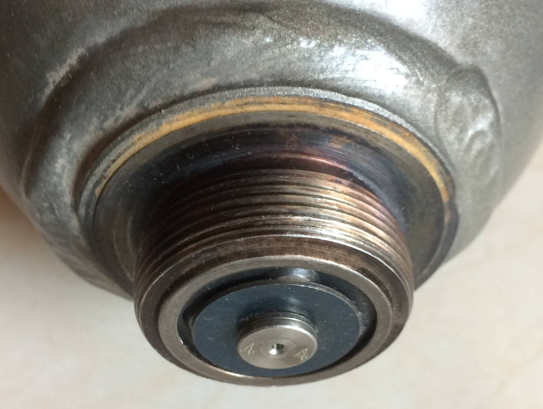

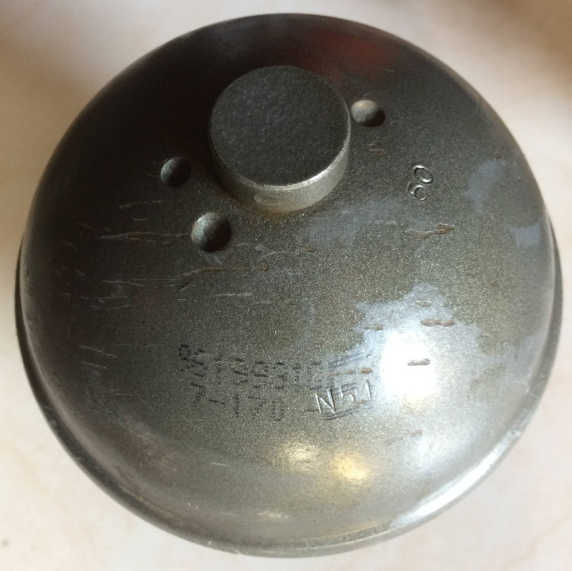

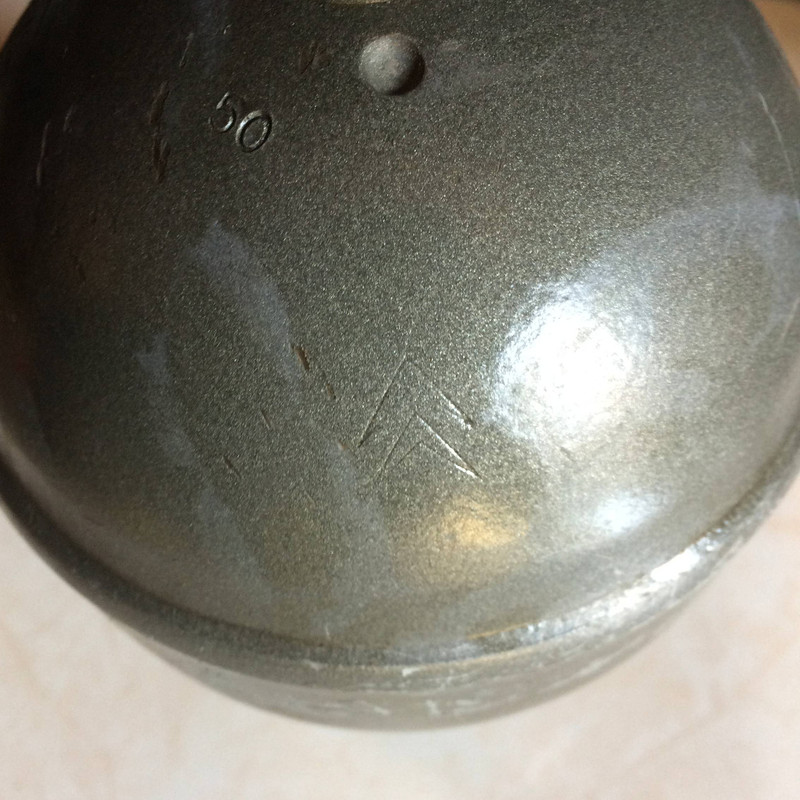

what about this one?
looks like fake citroen shpere
codes and citroen logo stamp are hard to see
have some holes on top and threads are not good as like I.F.H.S one.
but it wrote 4 on central damper!!
x 1746
That one looks genuine, with all the expected markings, including the small dotted numbers on the damper.
SFAIK, only Citroen genuine spheres have these damper markings, although we don't know how to decode them.
The three large dimples round the filler plug are how Citroen mark their "multicouche" (triple-layer) membranes, for use in hot locations on the cars. Again, these are exclusive to Citroen.
The sphere is painted in a non-standard colour. They are normally a matt plain green, or later ones are in grey metallic finish, to meet with EU 'gas type' requirements.
