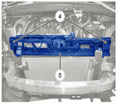

Once you have the vehicle in position, you should disconnect the battery following the BSI Reset / Battery Disconnect / Reconnect Procedure as the fan may kick in with the engine not running, as part of the post cooling operation.
Once you have taken off the following:
Refit:
Position the bonnet release cable.
Refit:
Connect and secure the connector (at "a").
Connect the connectors (at "b", "d").
Refit:
Then follow the battery reconnection part of the BSI Reset / Battery Disconnect / Reconnect Procedure
Check and top up the coolant fluid level if necessary.
Start the engine; Wait for the fan assembly to cut in then cut out.
Stop the engine.
- The front bumper
- The air resonator (according to equipment)
- The air filter housing (according to equipment)
- The headlamps
| Disconnect the connectors at "b", "d". Disconnect and unclip the connector (at "a"). Remove the bolt (1). Unclip the electrical harness (at "c"). | Remove:
| Separate the release cable from the engine cover. Remove:
| Remove:
Remove:
| Refitting CAUTION: Position the engine cooling radiator studs (at "e"). |
Refit:
- The cooling fan electric control unit (9)
- The (8) bolt
- The cooling fan (7)
- The bolts (1), (6)
- The upper crossmember (5)
- The bolts (4)
Refit:
- Transverse front section (3)
- The bolts (2)
Refit:
- The headlamps
- The front bumper
Stop the engine.
