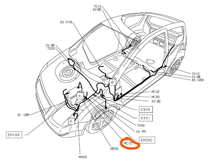

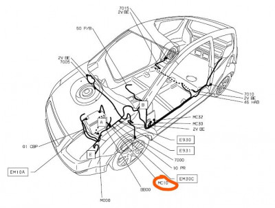

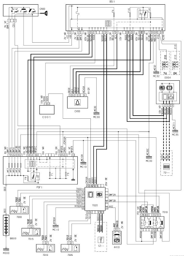

OK here is the diagram. You have already done most of the checks i would have done.
I would also check the earth at pin 26 but check it under load. Might even be worth removing & cleaning earth point MC10 anyway.
Does everything else on the instrument panel work as it should apart front the ABS light not illuminating & the speedo always showing 0?
Can Icarsoft connect to the instrument panel & actuate the ABS warning lamp (just to confirm the LED actually works)?
With the ABS unit disconnected can you measure the resistances across pins 25 & 19 and then 21 & 23 & confirm both read 120 ohms?

Thanks for the diagrams.
Everything on instrument panel works fine except ABS warning light. Speedo shows 0 and odometer shows the same figure. I'n not able to test the abs warning light with this scanner. I have opened the instrument panel and made visual inspection...all well I quess.
Resistance 25&19=114,3 ohm and 21&23=123,8ohm are these close enough or should I start fighting these wires?

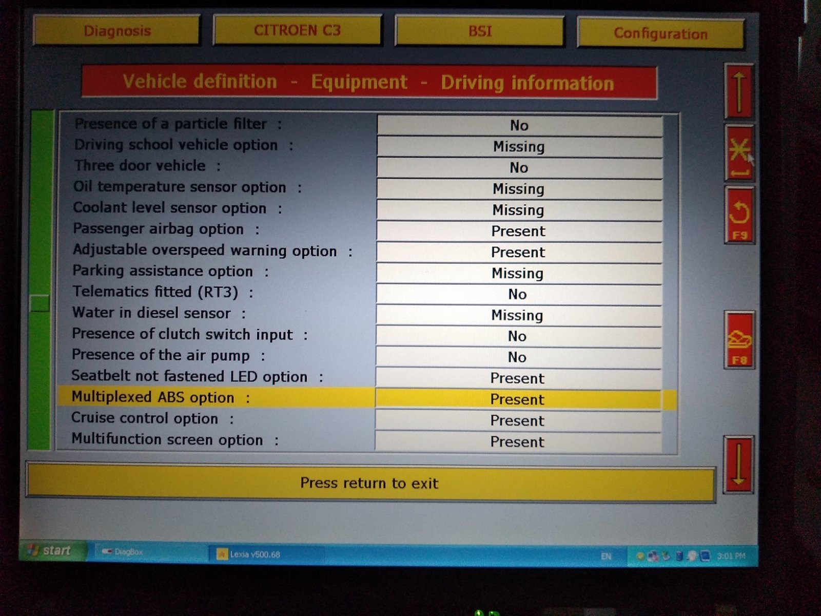

Yep. Looks like a configuration problem.
I went into the BSI configuration and found this: The ABS light comes on when the ignition is turned on When I changed the configuration to 'missing',
No ABS light. I did not drive the car but I bet the speed wont register. The configuration is in the driving information!

After hours of installation managed to finalize Diagbox/Lexia and connection to C2 was established
Took a while to think how the program works but found the ABS multiplexer... and quess what. It was in status: Missing. Managed to activate it and there we go.
Warning light illuminates now when I turn key and works as planned and even the speedometer works fine.
