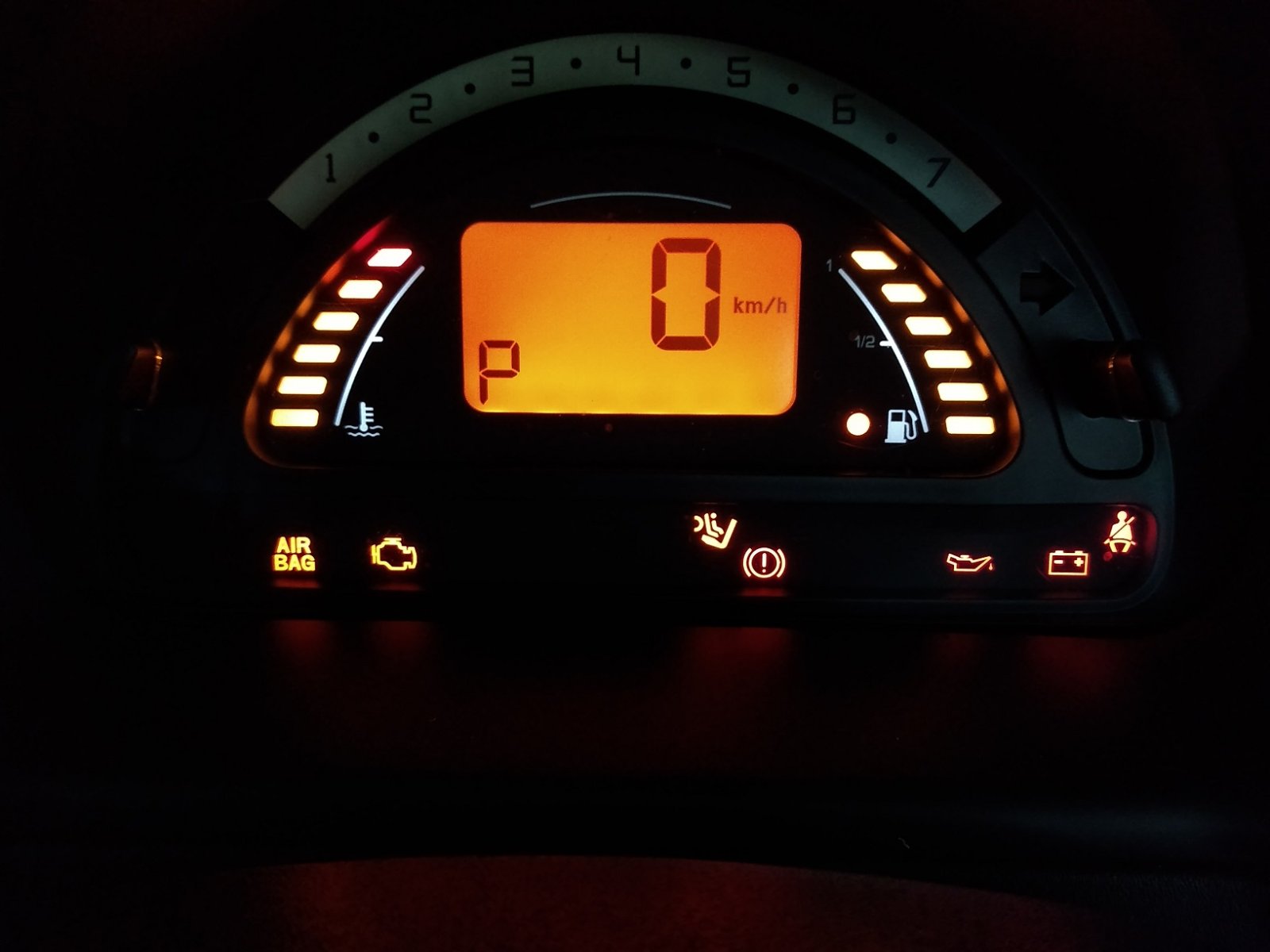

Hi, C2 1,4 petrol manual gearbox. ABS-problem. The warning light will not lit at all. I've just changed the abs unit but no change to better. Vehicle speed is in abs ecu and sometimes in steering ecu but not in engine ecu? Speedo showing zero. Fuses ok and there is voltage on abs connector pins 1, 14 and 20. ABS relay changed also but nothing seems to help this little black beast. I would need to find ABS/CAN wiring diagram, there is only abs no ESP in this car.

No diagbox, I have Icarsoft scanner. No fault codes in ABS unit at all and yes connection to all ecus. Engine ecu and steering ecu showing no vehicle speed faults.
I receive correct speed from all 4 wheels with scanner and its correct compared to gps speed. I havent found sensor on gearbox, I would guess the speedo info is coming from abs.
I can also see vehicle speed time to time from steering ecu but its unstable and varies a lot. Normally the steering is light all the time, maybe ecu thinks speed is 0.

Everything on instrument panel works fine except ABS warning light. Speedo shows 0 and odometer shows the same figure. I'n not able to test the abs warning light with this scanner. I have opened the instrument panel and made visual inspection...all well I quess.

I went into the BSI configuration and found this: The ABS light comes on when the ignition is turned on When I changed the configuration to 'missing',
No ABS light. I did not drive the car but I bet the speed wont register. The configuration is in the driving information!
