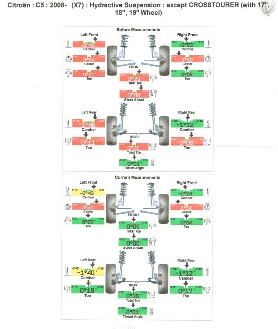

I had my tracking 'checked' and reset on my C5 (x7) back in 2017, attached is the final report I received, if I remember correctly the adjustment on the back (toe-in) was a pig to do and their comment was "not many garages have this equipment and cannot check it like we can" or something similar. I had mine reset and the tires do not show adverse signs of wear, so I am pleased. I have attched my report for comparison. - hope it helps.
As you can see the front was well out as I had only just replaced the rack!

Thanks for the look at the report Stu, that is interesting. I note that the front 'toe' readings are very much the same on both vehicles although none of the other front readings are but the rears dont appear to be much alike and at least yours are in the green whereas 4 of mine are red. It looks like its a question of whats adjustable and what isnt so I will just watch the wear over the next few months and see what evolves.
