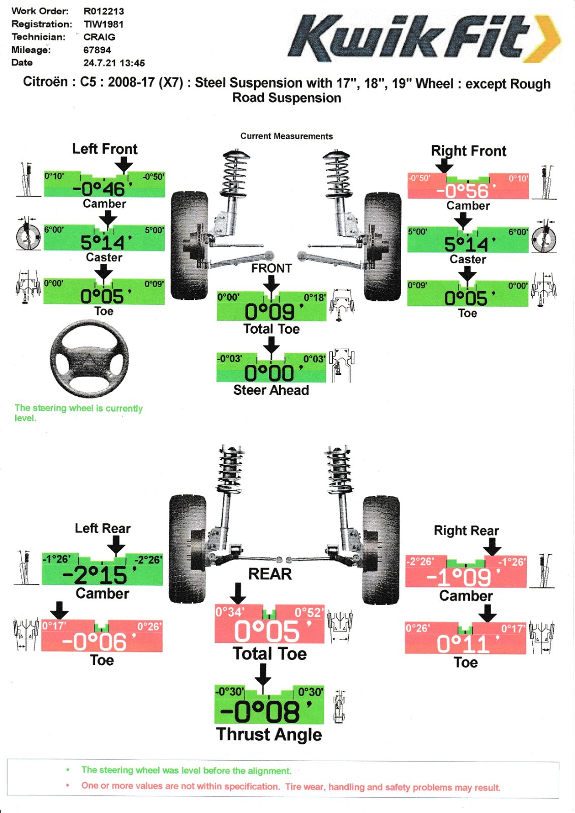

Today I have had 2 new Michelins fitted to the front of my C5 x 7 (2008) Petrol saloon and appropriate adjustment made on a Hunter Tracking system by KwikFit .
I am somewhat mystified upon reading the report to see that there are a number of the settings shown in red, one for the front wheels and 4 for the rear wheels. At the bottom of the report (as attached) there is the following : One or more values are not within specification. Tire wear,handling and safety problems may result.
I would be grateful for any advice or thoughts on the settings shown, should I return to KwikFit and ask why the settings are not within secification ?.

Re: Advice re C5x7 Tracking
Thanks for that Marc & Bobins.
I have to confess to still being in the dark after looking at the official settings from Marc as some of my current settings dont appear (to me) to be near the official data AND even more 'mystifying' is the fact that the majority dont appear to be adjustable anyway ??. Now to a lay person like me it seems hardly worthwhile ever having the tracking ' adjusted' in the first place as there only seems limited adjustment is achievable and yet common-sense tells me that clearly beneficial adjustment can be made otherwise every Citroen C5 owner would have been complaining bitterly by now at the cost of constant tyre replacement !. So I guess I will watch how the wear develops on the new tyres and see where we go from there.

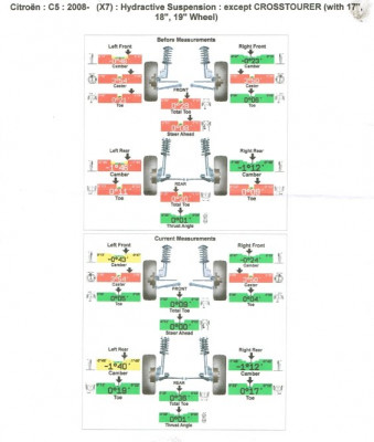

I had my tracking 'checked' and reset on my C5 (x7) back in 2017, attached is the final report I received, if I remember correctly the adjustment on the back (toe-in) was a pig to do and their comment was "not many garages have this equipment and cannot check it like we can" or something similar. I had mine reset and the tires do not show adverse signs of wear, so I am pleased. I have attched my report for comparison. - hope it helps.
As you can see the front was well out as I had only just replaced the rack!
Thanks for the look at the report Stu, that is interesting. I note that the front 'toe' readings are very much the same on both vehicles although none of the other front readings are but the rears dont appear to be much alike and at least yours are in the green whereas 4 of mine are red. It looks like its a question of whats adjustable and what isnt so I will just watch the wear over the next few months and see what evolves.
