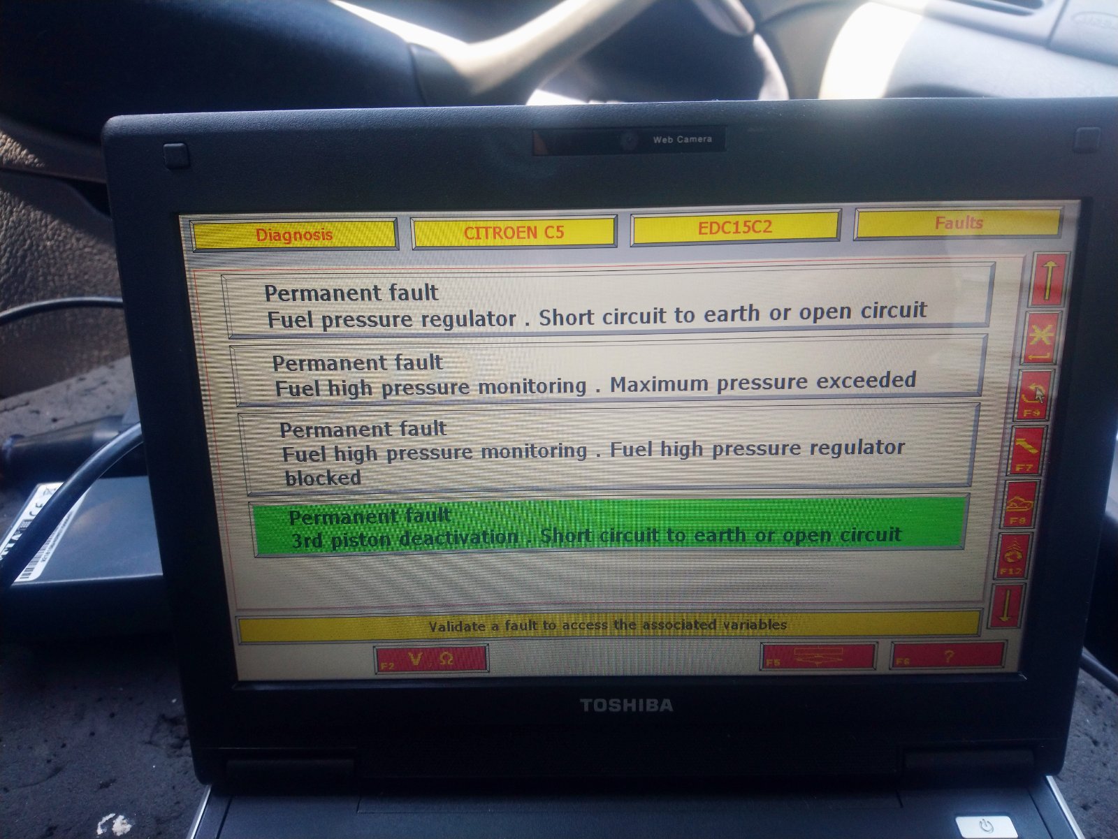

Well here's a number of interesting faults...
Let's do a clear and see what happens..

Ooooo I can't clear them... I can read etc..
But when I goto erase faults. Lexia reports Communication problem..

Just looking in lexia.. Fuel pressure regulator is showing a current of 2388.5mA... I think that's a bit high..
I think I'll double check the bsi fuses. Its strange lexia can't clear ecu faults

OK further lexia tests. I went into cooling fan actuator tests.. High speed fan good.. Cooling fan works.. Low speed fan... Different story..
The bsm buzzes and the fan doesn't work.. And I also did fuel line pressure tests.. The 3rd.piston was fine but the pressure regulator test produces exactley the same symptom as the low speed fan test..

Nothing changes.. All bsi fuses are OK..
So I think I must be looking at an ecu issue.. Its strange I cannot erase engine ecu faults..
