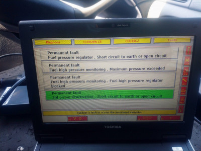

Well here's a number of interesting faults...
Let's do a clear and see what happens..

Just looking in lexia.. Fuel pressure regulator is showing a current of 2388.5mA... I think that's a bit high..
I think I'll double check the bsi fuses. Its strange lexia can't clear ecu faults

OK further lexia tests. I went into cooling fan actuator tests.. High speed fan good.. Cooling fan works.. Low speed fan... Different story..
The bsm buzzes and the fan doesn't work.. And I also did fuel line pressure tests.. The 3rd.piston was fine but the pressure regulator test produces exactley the same symptom as the low speed fan test..
