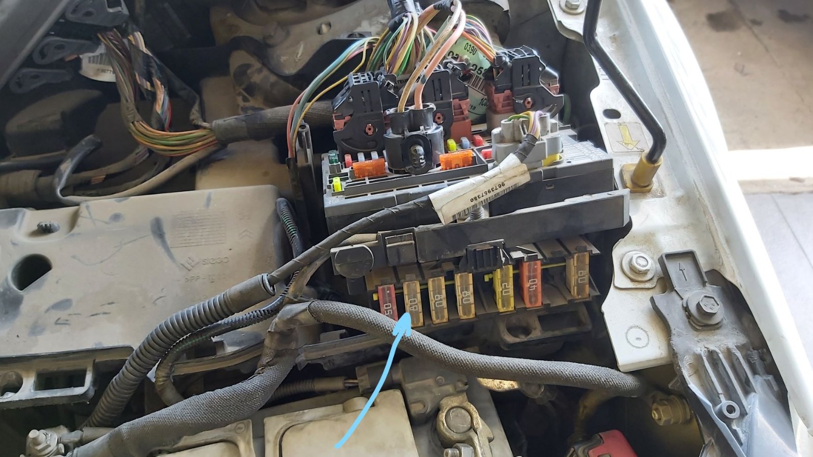

The problem solved. I explain here how. I took the car to the repair shop. I found that there is an extra maxi fuses box under the visible and exposed fuse box above the battery. (Photo No.1)

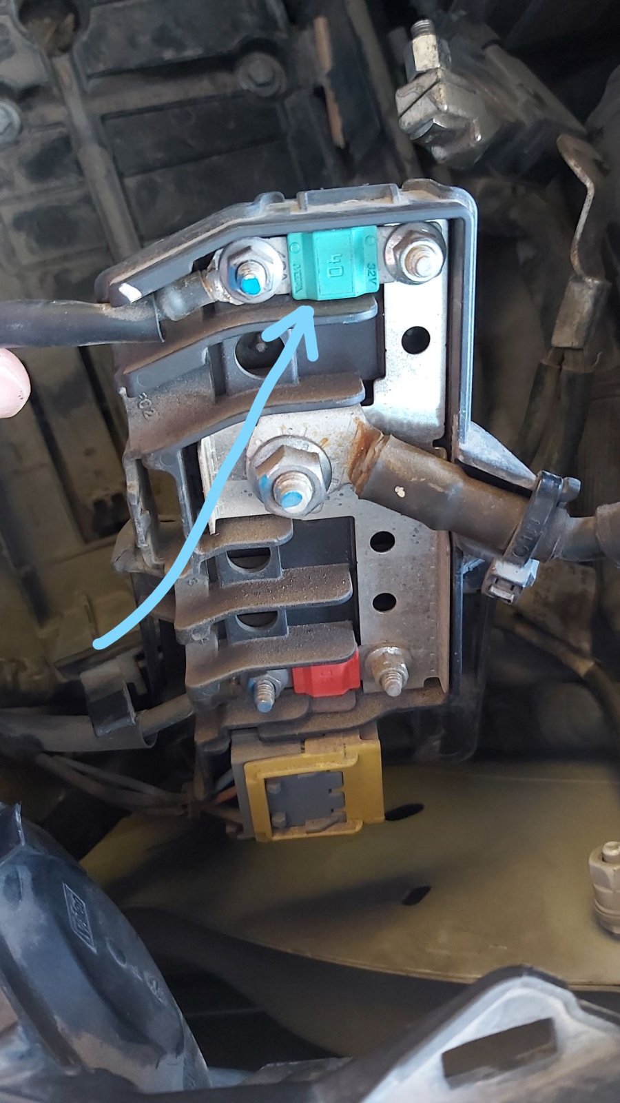

First we checked related maxi fuses and found them all Ok. Then removed the battery. At right side of battery there is another box with red color cover which is a power distribution box including 2 special fuses .( Photo No.2) one of them is 40 amp and is related directly to power of suspension system hydraulic pump. ( Photo No.3 ) . That fuse was disconnected . We replaced it and suspension system came back to its normal operation.
