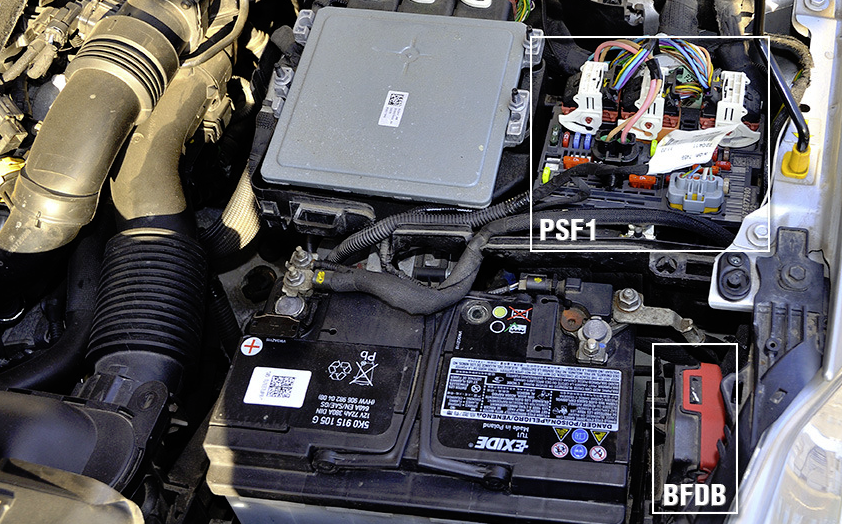

Here you go:

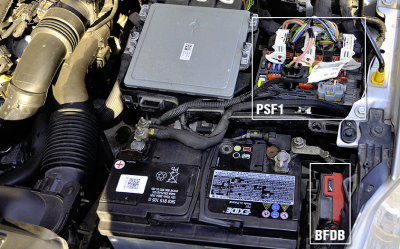

The BFBD Fuse box is beside the battery as shown above.

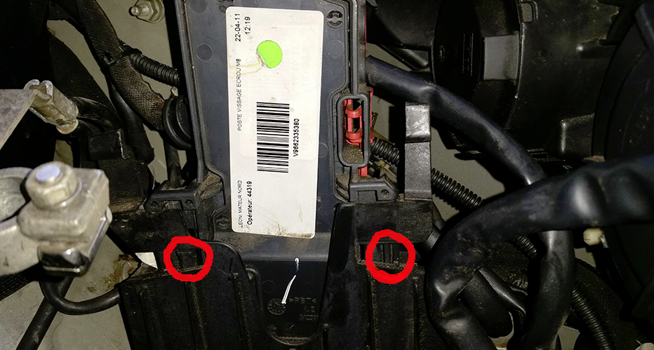

Remove the battery and you can remove the unit via the 2 clips circled in Red

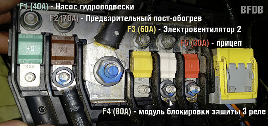

It is the Green 40A Fuse shown on the Left for the Suspension Pump.

In my car the battery fuse box has a 50A fuse in that spot and it also says that it should have 50A there. Neverteless, that fuse is broken!
I won’t be able to get a new fuse before evening, but this looks very promising! I was thinking to replace it with 60A fuse to prevent future problems. Is this a bad idea?

Not a good idea to increase the fuse rating. It has gone for a reason - motor drawing too much current presumably.
You could start a fire in the car .
It may be possible to use a higher rating to test the circuit for a few seconds but no more than that.

Yes they are officially 40A, so I suspect that this has already been changed!
A warning though - don't increaser the fuse Amp further - or you could risk a fire. The motor is overheating - and as I already said, it is likely to be LDS getting into the motor, either from overspill when filling the LDS tank, or it has got into the seal of the motor. This is a known problem. It is likely to go again until it is cleaned out and reassembled. There are a few threads on this.
