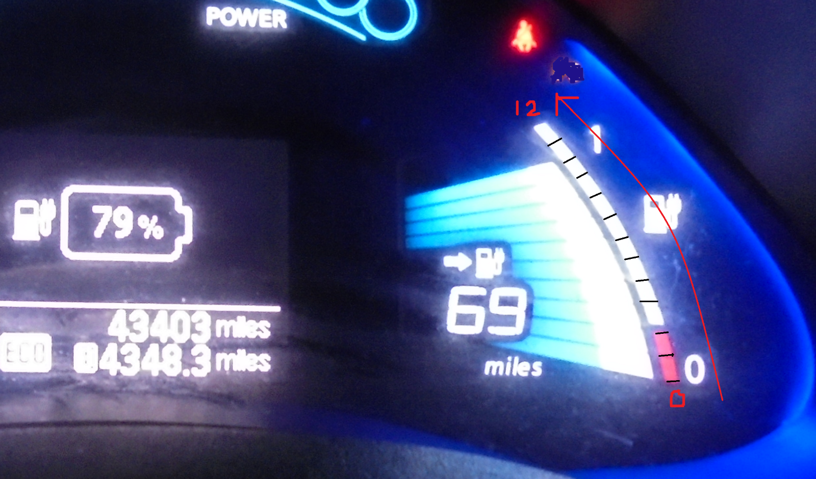

Somewhere in the Summertime since the Start of August when the mileometer was at 43,403, BBleaf has lost one of its 12 bars. Its battery in the 19 months of our ownership has done 15,000 miles of very gentle treatment.
So 43,500 miles and 6 years is the point at which the State of Health of the battery of the BB Leaf drops to 85% of the original capacity of the pack. The first bar loss represents 15% loss, subsequent bar loss represents 6.25% further loss.
I would have liked to keep the 12 bars longer, but the loss of capacity is inevitable with age, and charging cycles.

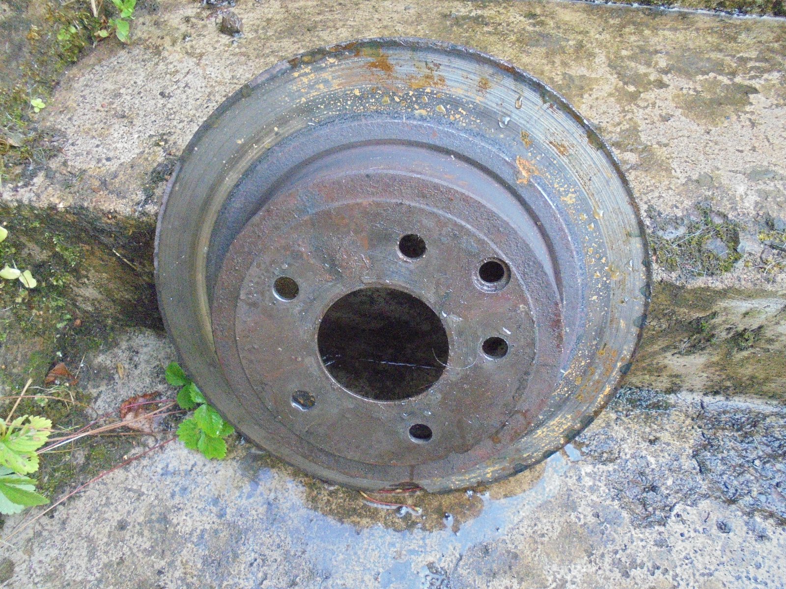

The old BB Leaf isn't entirely Maintenance free. With the MOT coming up in September, discs and pads need a bit of attention. The nearside rear was giving the graunch of pads worn down to the metal so the job has started.
Its an odd set up on the leaf the rear disk is a disk and drum combined, with a handbrake and brakeshoes acting on the inside of the disk, and your normal caliper and pads on the outside. Its a mechanical handbrake (foot operated) operating on the little shoes inside the disk.

Re: Bargain Basement Electric
That is a fairly common arrangement these days Neil, especially on Japanese cars. I was surprised to discover the Kia Venga does not have that arrangement!!
With a normal handbrake arrangement operating on the rear wheels where there are disks on the rear wheels, the pistons on the caliper have to be wound back. I cant quite work out whether the Leaf ones do or not. Nissan say use a piston rewind tool but I cant see any connection at all between the caliper and the handbrake mechanism which is a cable operated thing acting via a lever on the shoes.mickthemaverick wrote: 28 Aug 2021, 19:09 That is a fairly common arrangement these days Neil, especially on Japanese cars. I was surprised to discover the Kia Venga does not have that arrangement!!![]()
Any thoughts?
- x 2941
Common Volvo and Saab set up Neil.
