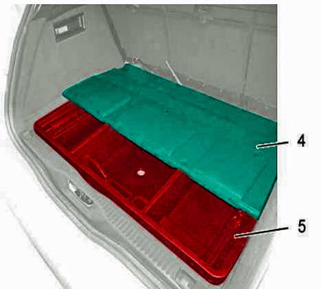

Ok, so you access the top of the rear strut from the boot:
Remove:
The nut is then exposed at (9) above.
Torque:
The Nut at (1) needs to be tightened to 4,5 daNm
Remove:
- The boot carpet (4)
- The boot end trim (5)
- The bolt (6)
- The cover (7)
Torque:
