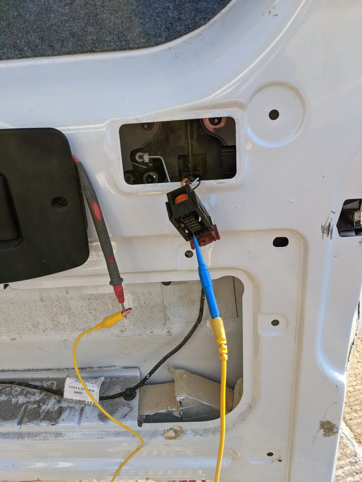

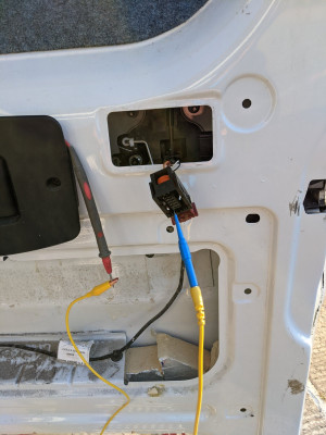

Hi,
I have spent the week checking the van over look for the on going fault.
Rear door switch
Rear door switch
Checked all the door switches. All seem to be 2-3v with the ignition on and 0.06v with it off

wheeler
Posts: 6886
Joined: 21 Sep 2002, 19:07
Location: United Kingdom
My Cars:
x 731
Re: 2015 Citroen Relay Central Locking not operating
Post by wheeler »
If its the unit im thinking of its behind the dash sort of behind the radio area.
