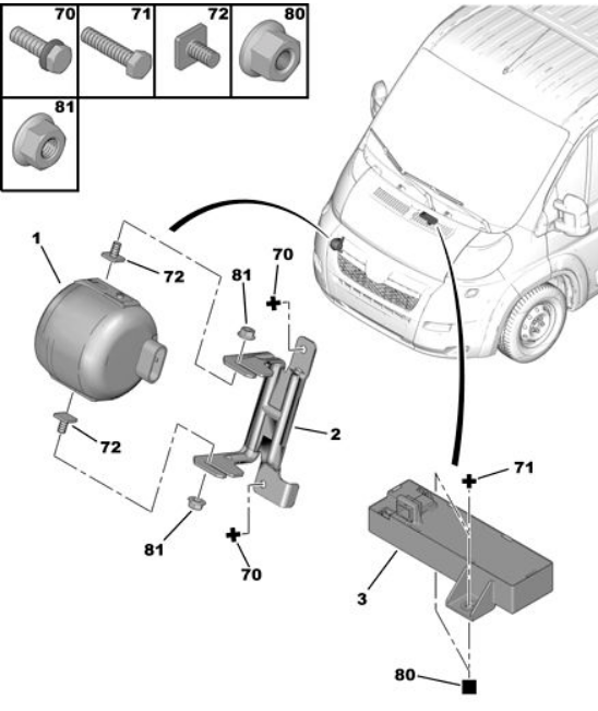

I have a 2015 Citroen relay panel van (35 heavy L4H2 eprise hdi) and the problem is the central locking has stopped working on the key fob, button on the driver door and the button on the dash. I have had it scanned at the local garage and its showing BSI code U1412 Alarm Siren Control Unit (ASU) fault.
I did a search of google and found this site with parts diagram of the location of the siren and module. I am struggling to find the module (e16 in the picture)and would like to now if anybody can give me a more precise location of it. I spent the afternoon looking around the engine bay and take some of the dash apart.
Does anybody now if the module can be tested with a volt meter?

Have you checked all the fuses?
Does your dash display show when all the doors are being opened & closed?
The alarm siren is located behind the front right wing, you need to remove the wheel arch liner to access it. Would certainly be worth checking for water ingress in the connector.

Hi,
I have spent the week checking the van over look for the on going fault. Checked all the door switches. All seem to be 2-3v with the ignition on and 0.06v with it off
Found the alarm siren. All the connectors where good. No power at the connector. Continuity across the siren.
I also pulled all the fuses and relay and checked them.
I think my next question is where is the control module is it under the bonnet or dash ( no. 3)? Thank you all your help so far.

wheeler
- Posts: 7927
- Joined: 21 Sep 2002, 19:07
- x 1056
Re: 2015 Citroen Relay Central Locking not operating
If its the unit im thinking of its behind the dash sort of behind the radio area.
