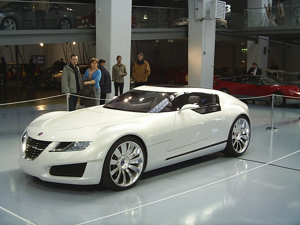

I wonder how we will manage with the E85 being used in some places.
Buy SAAB Aero-X's perhaps.
